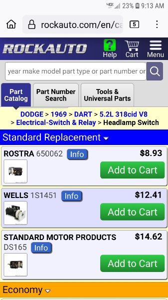

Dave thank you so much. I cant get under the dash anymore ( back problems) so I will get my mechanic neighbor to help. I did pull an amperage check with the lights on high. It was close to 5 amps which should be ok if I have read right.
Any recommendations on brand of switch to use? OI replaced the switch when I restored the car several years ago.

All currently-production new switches are Taiwanese or Chinese. If you want olde-tyme quality, hit up Old Car Parts Northwest or eBay for a new old stock American or Canadian switch.

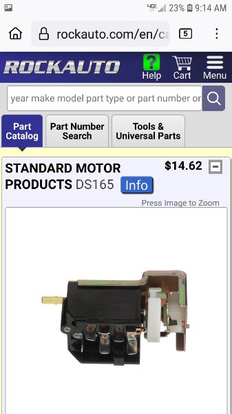

Ron Francis swears the light switch he sells is American made. Been selling the same one for years. Didnt get to check the dimmer switch today. Ron Francis says to check amperage put your DVM in series on the main feed and dont use the clamp on type.
NOS 1974-1978 PLYMOUTH CHRYSLER DODGE STANDARD HEADLIGHT LAMP SWITCH DS-146 | eBay UK? 7 pin switch probably the wrong one but 2 minutes ebay wrastling even from the UK ebay turned it up...
