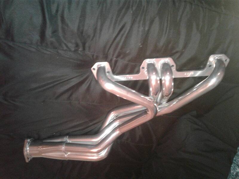

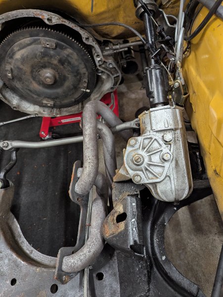

I am getting ready to install the original 340 back into the Duster. The drivers side Headman header has the steering drag link running through it. Do the tti and or Doug's headers have a better design than this? I was planning to remove the drag link and repaint these headers but at this point I'm wondering if it would be better to just replace. Also, if anyone hade the measurements of the tti or Doug's I would appreciate it as I just had new 2.25" exhaust run from the headers back

There is a Hooker Super Comp set that do not wrap around the center link, #5115. But these are no longer in production and you'll have to find em at swap meets and I don't know if they will fit an A body.
Hooker 5115's are B&E body only headers. I used to have a set on my 71 Challenger conv when I had the 340 6 Pak motor in it. They are nice headers for the B & E's, but won't fit A bodies. I prefer Dougs D453's for A body.

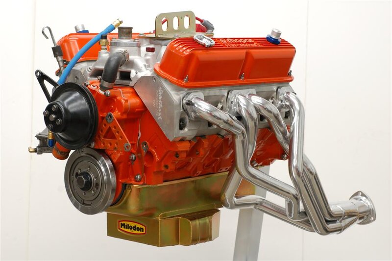

Do the Doug's headers model D 453 clear a 727 trans with column shift and a standard oil filter set up (I prefer not to use the 90 degree setup)? I have purchased a smaller starter so I think that will clear. Also any overall dimensions if possible so I can see if it will bolt directly to the exhaust I have. Thanks

I’ve installed … cyclones, Hedmans, etc., and I’m just saying that it will be dougs for me going forward. The benefits of the installation, room around the starter, ease at spark plugs # five and seven, no steering arms going through them, thickness of the flange, and the quality of the welds, Couple hundred bucks more than worth it…, but that’s just me.
I changed the starter in my Duster in about 20 minutes with the Dougs. Didn't have to even loosen the header. Just turned the steering one way - i believe to the right all the way. I do have a dakota starter.
Wow, I need to look at that. When looking at the setup it seems the header needs to come loose but I need to try what you're saying. Not that I want to yank that starter!!!
The higher end Hedman Hedders had a slip joint in that pipe and the head flange was separated so it could be installed as an individual pipe. Easy with manual steering to take the headers to an exhaust shop and have then cut the pipe and sleeve it with a slightly larger pipe welded to the collector side of the pipe.
