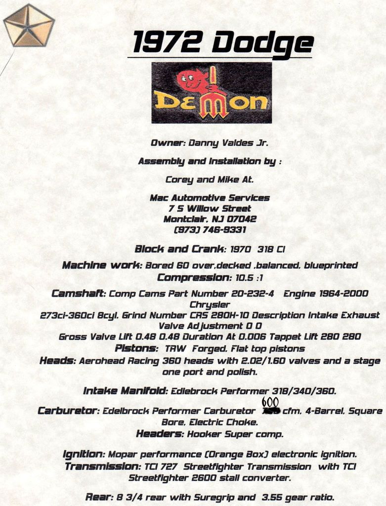

scaned my info sheet i made up when my mechanic rattled off what we put in the engine..also the 360 heads were from aerohead racing , the description of them is as follows :
1968-1987 340-360 A-Engine Assem., 1.88 or 2.02X1.60 Stainless Valves, 67-70cc Open Chamber Design, .509" Lift Springs, 160cc Intake Port Volume

BJR/ Demon dan - I dont want to be negative :sad7: - but with a :
2600 stall
3.5 gears
10.5:1 comp
280H cam
headers, 600cfm carb etc....
Surely this thing should be patching a little bit, even with the larger runner 360 heads?:dontknow:
I mean Im assuming the compression was calculated with the heads he is using? -
if so......Im thinking there's something weird going on:snakeman:...That thing should at least turn the tyres with that much advance in the ignition.....and Im suprised its not "pinging" its brain off.......
Dan- when you have the chance - get the cam degreed (even if your shop claims they did it) ......it smells of being seriously retarded....
