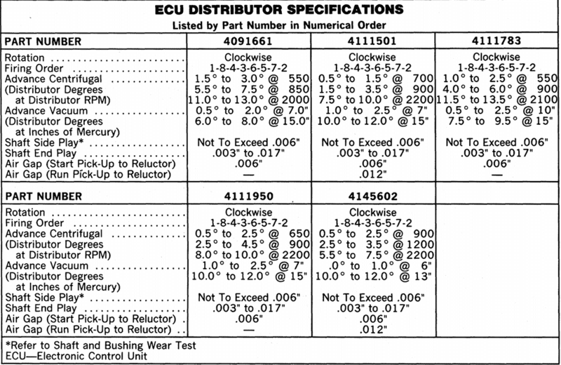

I keep seeing .008" but my 1983 manual has .006". Granted, when I checked it yesterday, it was >.010" and I've set it at .006". My truck came with the 4111950 originally.
I'll be up front that I'm definitely not a Mopar guy. I grew up messing with Fords, Jeeps, and mostly imports. So, if there is some inside knowledge about the .008" I'll set it for that. The only place I see .008" in the service manual is for a "go/no-go" check. If it's wider than that, it says to set it to .006".
That is also of course with the engine off. It's a new Chinesium dizzy, so it may be fluctuating with advance. That is something I'm not really set up to test, or at least I'm not sure how I could. Any ideas would be helpful; the manual just says to "mount in a reliable stroboscope-type distributor tester" which I would if had access to one for checking the mechanical and vacuum advance curves. I'm sure I could rig something up with a drill press, but an actual old Sun 404 or 504 would set me back more than 4 or 5 distributors. If there is a "trick" I'm all ears.
