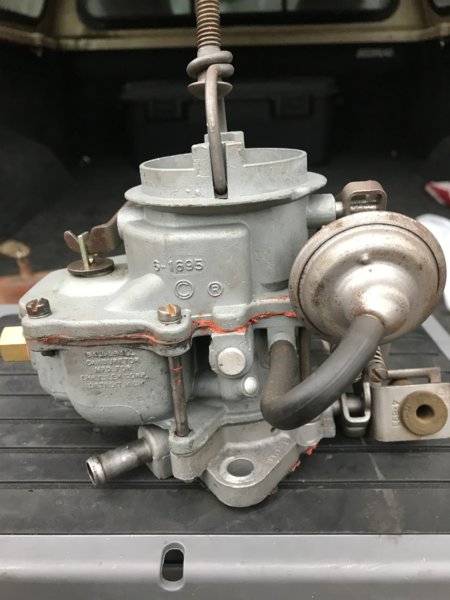

    Does 20200112_151442.jpg 20200112_151225.jpg 20200112_151446.jpg someone said my float is stuck and it needs a rebuild along with new tank. Anyone know the proper rebuild kit for 66 dodge dart 170 Carter BBS 1bbl?

    Geez, what a scuzzy carburetor. It needs a overhaul and probably has a hole in the float. That makes it heavy and keeps the needle and seat open so it floods anywhere it can.

      Look for the number of your carburetor located on it's side and match it with one that is listed on this link.

      I thought the numbers on the Carter were on a tab of some sort, that I think ripped off as I can only see side stamped numbers

      This is one that I just sold. I believe those are the numbers on the bowl. af17c09b-8522-4b47-af32-295c29b09474-jpeg.jpg

      I thought my other one had a tag on it, but it doesn't. I do know that I bought it from a company Uremco part# 5-565

      Summit has this carb, by that part number 5-565

          be careful tightening that carb bowl cover. I can see in your picture somebody has already partially stripped out one of the bowl screw heads. That cover is very soft pot metal, and if you get too forceful tightening those bowl screws, it can permanently deform the cover and you'll have a hard time getting it to seal.
