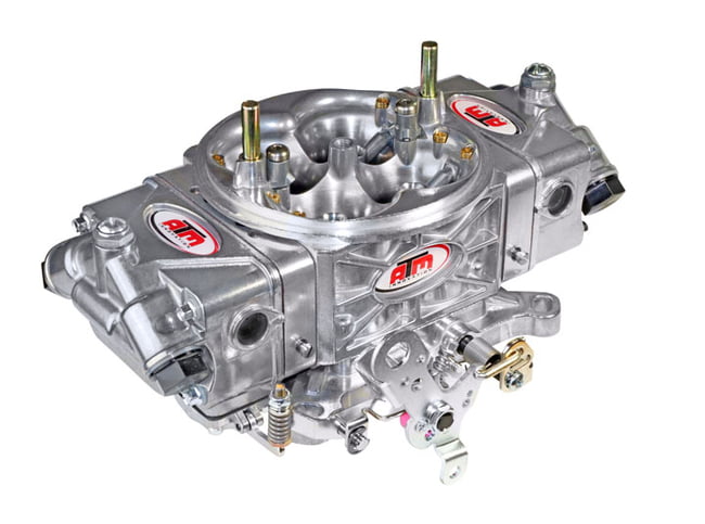

Look at ATM brand carbs. They are good people to work with.
XRC Race Series Gas Carburetor​
XRC Race Carburetors​
<< Back
ATM’s Gas XRC Series "Race" carburetors "no vacuum ports" will fulfill the needs of most racers with advanced fuel control from the ATM™ all aluminum fuel bowls to the fully tuneable air bleeds and fuel channel restrictions in the ATM™ die-cast aluminum carb bodies and metering blocks. They are available in 5 sizes from 650-1050CFM (4150 style).
Gas carbs come with a polished silver finish standard.
Part #: XRC
Price: $555.56
