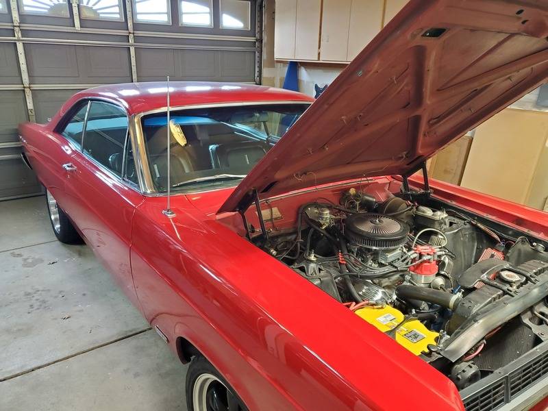

Ug.. the stock intake on a FE... what.. 80lbs+? Nearly herniated myself swapping it out on my 390 for a Streetmaster. And you have the added bonus of the pushrods going THROUGH the intake as well! Next ask how fun it is to get longtube headers between the shock towers on an older Ford. 390FE in my 67 Fairlane as it sits today.
Yes.. my home is integrated.... Mopar shares it's home with my Ford. :D
