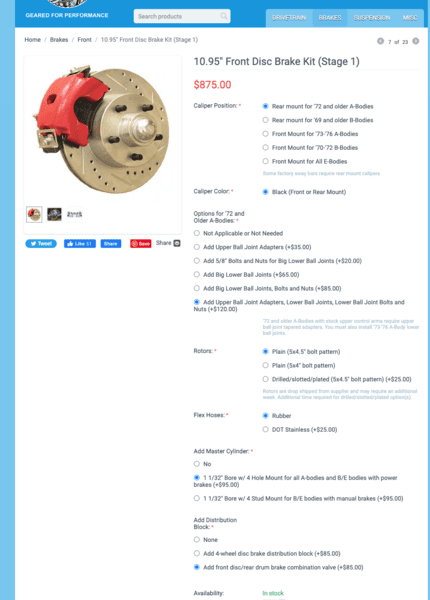

Is the 10.95 inch front disc brake kit on doctor diffs website all i would need to order? Also do you know if they accept debit cards? cause i haven't made a account with them yet. at work so kinda busy.

Yes, the 10.95" kit is what you would need to order. Unless you decided to go with 15" rims, in which case you could run the 11.75" stage II kit if you wanted. With the 73+ kit and going from drums to disks you're going to need a lot of stuff, the tapered adaptors, lower ball joints, new master cylinder (disk/drum) and a proportioning/combination valve. So with everything you need it would look like this...

Keep in mind though that even with the other conversion kits you'd still need the new master cylinder and combination valve, new hoses, etc. And unless you keep the 9" spindles you'll need spindles.

Thank you so much for helping me out on this i really appreciate it! Now one more thing if i get that 10.95 doctor diff kit i think i might just change the front to a 5x4.5 simply because there is a better rim selection. Can you still use the stock hubcaps with some aftermarket rims or no?

The reason i dont wanna change the rear really is because i just changed everything there about a month ago. Drums, shoes and hardware. Oh and another thing sorry, how wide of rims can i get i think if i go over 6 in.it will possibly hit the fenders found 15x6 5x4.5 with 3.75 inch backspace. but idk and how much backspacing do i need? the doctor diff kit dosent say. By the way bluNblu it didn't show me any 14 inchers on your summit racing link but no big deal seems hard to find 14's that fit discs in them anyway. EDIT: im also wondering that dr diff kit only has the option to get the a-body master cylinder with power brakes and i dont have power brakes do i have to buy a different one seperately? Sorry for the question bombing but im learning as i go.
