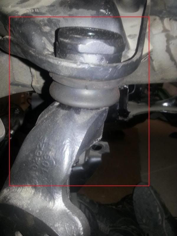

Update: I am not crying. :) So I am pretty sure this is a case of my mistaken terminology, and a migrane! My ball joints are threaded, and already threaded on, I am talking about the other end of that ball joint with the castle nut, that connects to the spindle. Basically I am talking about all the parts where there are castle nuts. Those are pressed in correct? Such as the following:

So I am pretty sure this is a case of my mistaken terminology. My ball joints are threaded, and already threaded on, I am talking about the other end of that ball joint with the castle nut, that connects to the spindle. Basically I am talking about all the parts where there are castle nuts. Those are pressed in correct? Such as the following:
Just tighten up the castle nut and put the cotter pin in. They are a tapered fit so there is no need to press them in.
That tapered pin is drawn into the spindle by the castle nut. The same as the pitman and idler arms. Don't forget to use the cotter pins. I don't know the torque specs but someone here will have it.
I would hand wrench,as tight as you can. That taper needs to seat,ball joint to hole. Tight all the way,back off a flat. (Install cotter pin,spread it). I've used this 25 + years,I'm still alive. Just completely, seat the tapers. Do the cotter pin ,correctly.
Please read my post no7. You just insert the tapered stud, thread on the nut. There is a torque spec in the shop manual.

There IS a torque spec for castellated nuts. However, you can rarely get the slots in the nut to line up with the cotter pin hole in the stud, so, what you do is, torque them to the proper spec, then, if the slot is not aligned, simply tighten the nut to the next slot and line it up and install the cotter pin. NEVER under ANY circumstances loosen the nut to align the slots. Always tighten to align. It will be a little over torqued, but will not loosen up.
