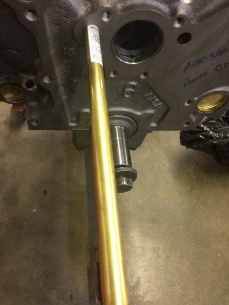

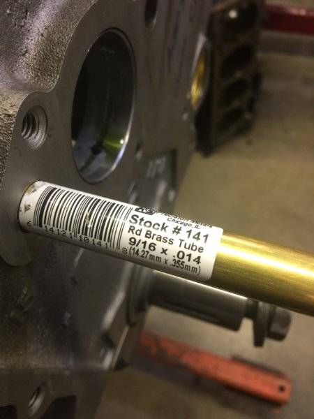

I have two 360 blocks that need the lifter gallery’s tubed. Now I have no issues doing this on a stock 360 block but both of these have already been machined. Bad things can happen as we all know when enlarging a hole 10 inched in a stock cast iron block. Messing up a 50.00 block wouldn’t kill me but 1000.00 block would. Well while looking for my long 5/8 drill bit for the soft 1/2 (5/8 outside dia) house water line I usually use I grabbed a piece of my K&S tubing I keep handy. Wow is this a nice fit. A fast ream with my 9/16 drill bit and tap it in. Only issue I see is it is only .014 thick. I have the Direct Connection peening tool so I’m not worried about tearing it. What do you guys think about this. I’m thinking I’m going to give it a go.
If it gets screwed up, could you not just re drill it out?
Besides the tearing while running the peen tool? What issue are you thinking about? Sorry, I feel like I’m missing some.
Yes easily. And I’m thinking once in place what could happen honestly. This would make this job so much easier for everyone if it works.

That will work just fine. I stopped using press fit years ago. Once you peen it, that thing ain't going anywhere.
I also learned something years ago. After peening I always take a paper roll and just lightly buff the tube so the lifter never rubs on it. That way, it can never wear a hole in it.
I had a couple of lifter bores get holes in them. I think the edge of a junk set of lifters was rubbing on the tube and put holes in it.
After replacing the tube I started buffing the tube down so nothing can grab it.

Like yellow rose said the lifter does touch the tubing slightly. I would just like it to be a little thicker. I found some .032 thick 9/16 but for as many blocks as I do I’m not paying over 50.00 for a 3 foot length. 6 foot heck ya, but not 3 foot.

I did my 360 block years ago, because the machine shop I was going to didn't want to do it. I got a Ed Hamburger kit, it was a piece of 9/16 steel tubing, and the tool to peen it. Had to buy a 9/16 drill, an have it lengthen. So 9/16 outside diameter will work
And this is the tube your looking at to use instead of the other one posted
I was just checking around to see what else I could find. I’m sure the K&S tubing will work just fine. I will run my long 9/16 drill bit in there just to clean up some casting.
