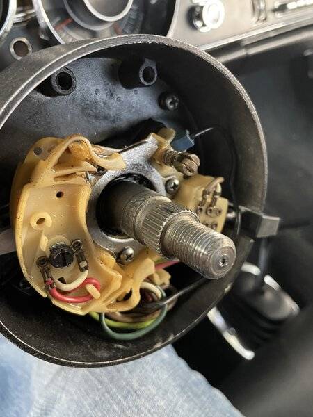

I have a 70 Dart Swinger that the horn has never worked since purchased. I got around to fixing it this week and after tracing and testing all wiring I found that there is a gap of about 1/8" to 3/16" between the steering wheel contact ring and the roller contact on the turn signal switch. Everything else seems to line up properly so I am guessing I have either an incorrect steering wheel or TS switch. Can you experts please take a look at my pics and see if something looks wrong? Thanks!!

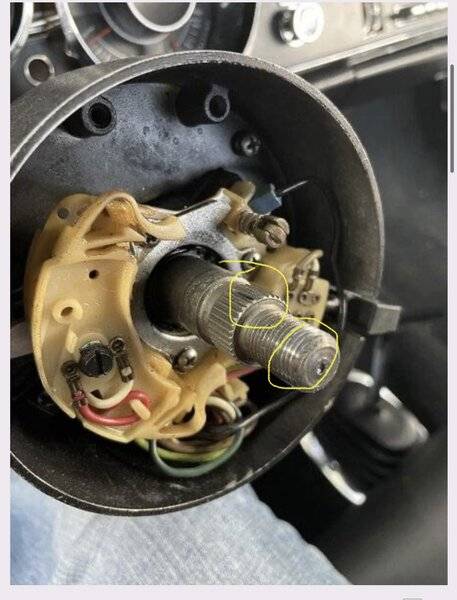

Looking at this photo was the master spline on the steering wheel lined up to the master spline on the shaft? The spline area I circled looks chewed up to me. It also looks like the nut only engaged about 6 threads. If the splines are boogered up the wheel could be hanging up and not sliding all the way on.
Funny you should say that. I noticed the shaft too but dismissed it.
IIRC there is a keyway spline on the column and on the wheel if the two were not lined up wouldn't that too prevent the wheel from sitting all the way down, mark up the splines?
Hi Dana, yes there is a “key” on the wheel and shaft and the splines around the dark colored spline looks to me like they’re rough or damaged, like the keys weren’t aligned. If that’s the case a little work with a file should clean it up.
Thanks guys, but the wheel slides onto the splines fine and goes all the way down. The little roller on the the TS switch sits at the same height as the shelf on the shaft that the base of the wheel sits against, yet the contact ring is 3/16" above that shelf on the wheel (see pic with ruler). I noticed in looking at replacement parts that 69 switches all seem to show that rolloer like mine have but 70 switches just have a spring loaded pin. I'm not sure if 69's had the flasher button on the switch tho? Can anyone confirm if maybe there was a height difference between the 69 & 70 switches? BTW, the gap from the wheel to the column housing is good which also confirms the wheel is going on all the way. Always something on these old beasts!! lol
The turn signal switch with roller was used on all Valiant, Dart and Duster cars in the 60's and 70's. Even the Aspen and Volare used the switch with the roller. The roller type switch was replaced by the pin style in the early 80's. Most of the aftermarket replacement switches made today are the pin style.

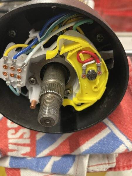

Thanks for this link .... I have already ordered and installed the replacement switch and ring from Classic Industries. I agree, the quality of that switch is not up to the OEM level but it did indeed solve my issue. I did the new ring only because the insulation on my old one was falling apart. Still a mystery why the contact on the switch I had did not touch the ring. The contact on the replacement switch sits a good 1/8" to 3/16" higher than the one on the switch I had.
