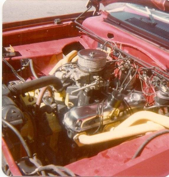

I used the Cyclone fenderwell headers and never experienced any exhaust leaks, but I can't remember if they were patterned specifically for the 273 exhaust ports or the larger 340 ports. Edit: Now I remember matching the header exhaust gasket with the cylinder head port a little bit with a Dremel tool mini-grinder.
