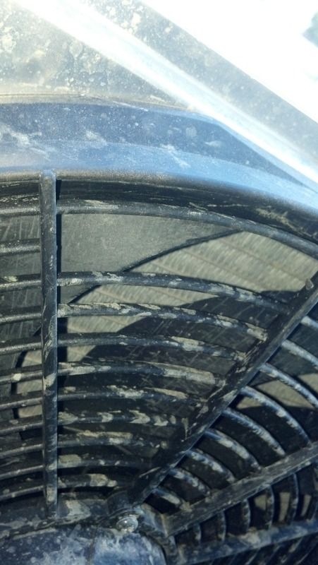

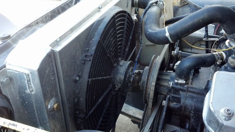

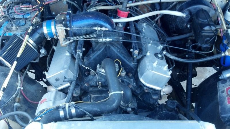

I looked through the pics and you don't have any underhood ones, any chance you could take a pic of the radiator/fan setup? What may be happening is the shroud is covering up parts of the radiator and restricting airflow; also the electric fan may be mounted too close to the fins which also restricts airflow. You are putting the engine under high load without much speed so getting sufficient airflow through the radiator at low speeds is critical. I might even argue in this case that a belt-driven fan would work better than an electric one because the fan speeds up along with the engine and pulls extra air as the RPM rises.
EDIT: Lower hose spring might be a good one to look into as well, it might be collapsing when you hit the gas...
Ill take pics after work. Can't use a mechanical fan because I had to offset the engine 4" to the passenger side to clear front drive shaft on the 727 pan.

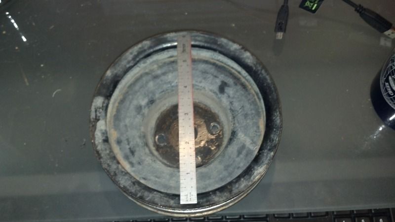

what size pulley should a NON A/C engine use?
what size pulley should a A/C engine use?
My pulley is a 2 belt, and is over 6" in Diameter.
