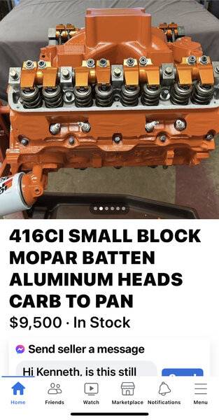

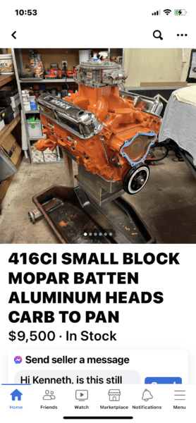

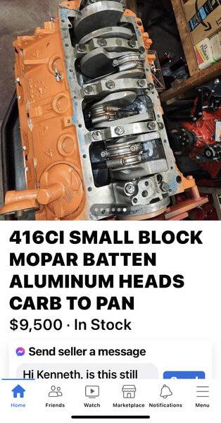

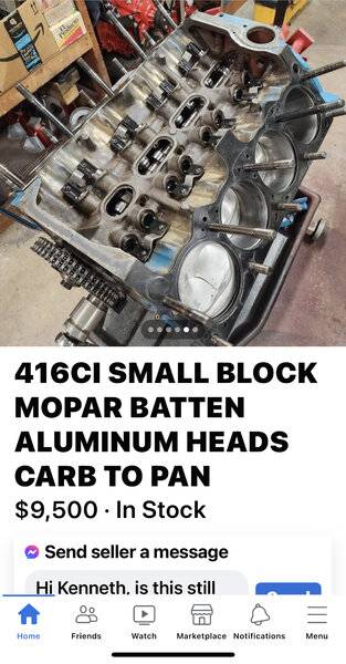

Here's your 700 horse
That would do the job!
Not mine. Another Facebook find.
UP FOR SALE!!!
So my friend just decided to sell this 416 cubic inch, W-2 Batten aluminum head engine. Price is $9500 carb to pan. It was just freshened up. Engine specs are: 340 block .030 over (1972) • Eagle forged crank – 4340 340006123 • mains and rods are std/std. • Clevite MS540H Main Bearings • Clevite Engine Parts CB-481HN - Clevite H-Series Rod Bearings • Eagle H beam rods - 6.123" 4340 H-Beam, Chrysler Small Block, 7/16" Arp 8740 Bolts. • ATI Super Damper. • Ross pistons (Chrysler ‘A’ Block: 340 – Dome Top: 4.070 Bore – 4.000 Stroke – 4.20CC – #99788) • Total Seal Piston Rings CR7590 35 - Total Seal CR Classic Race Piston Rings • 13.1 comp with .060 Cometic head gasket • Batten w-2 aluminum cylinder heads, rectangular ports, ported by Shady Dell 2.125"/1.60" valves, flowed 320.9/I and 222.5/E @ .700 • ARP Head Studs. • Harland Sharp 1.5 ratio Roller Rockers with shafts and stands. • INDY 360-I4-3R (fits 360-1) Manifold modified for 4500, rectangular ports, port matched to heads. • Lunati Drag Race Solid Roller Cam - Chrysler [hidden information]/310 #40200914 ( Advertised Duration (Int/Exh): 302/310; Duration @ .050 (Int/Exh): 273/281; Gross Valve Lift (Int/Exh): .640/.640; LSA/ICL: 106/100) • Comp Cams Endure-X Solid Roller Lifters for Chrysler V8 273-360, .904 (828-16) • Smith Brothers 3/8” push rods. • Stef's extra deep Oil Pan. • Melling M72HV Oil Pump
1050 Quick Fuels Dominator.
Engine is located in Bowie, MD See less
Why because it says it’s 700 horsepower. Hmmm my sons stock crank 360 ran 6.54 with 13 year old Edelbrock heads. It’s full weight too. I hope the nitrous wasn’t used on this 6.30 passes.
No Looking at the specs on the engine it should make close to 700. Your Edelbrock and speedmaster stuff runs great, makes great power but the OP is asking for more hp than those heads are capable of.
