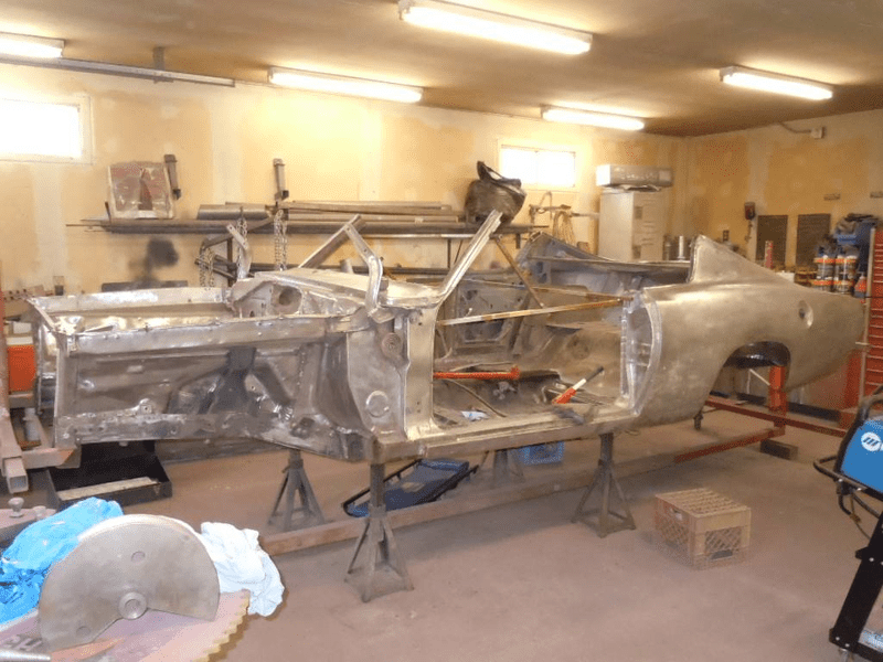

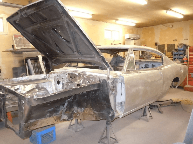

I found it on my 68 Barracuda Fastback when I disassembled it for a rotisserie restoration. I took every nut, bolt , washer, fastener , clip, wire and plug off the vehicle personally.
It is possible it was put there by someone else but it looked factory and didn't look disturbed when I took it off so I was careful to put it back where I found it.
WOW !! a real labour of love. Have you progressed any further ? Any updated pictures or pictures of completed project. Thanks for the imput

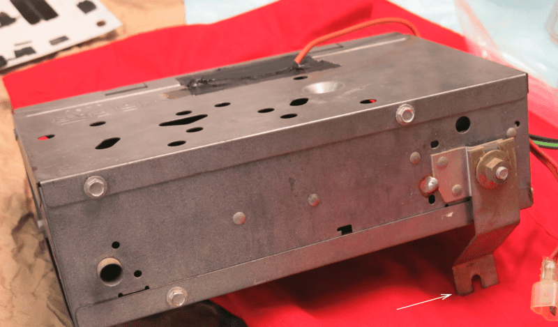

On my '67 its a wire with two ring terminals the other end going to the radio supportscew where it mounts to the dash.

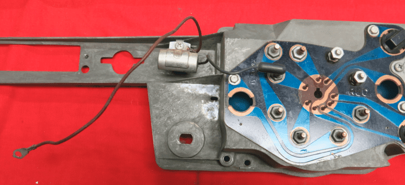

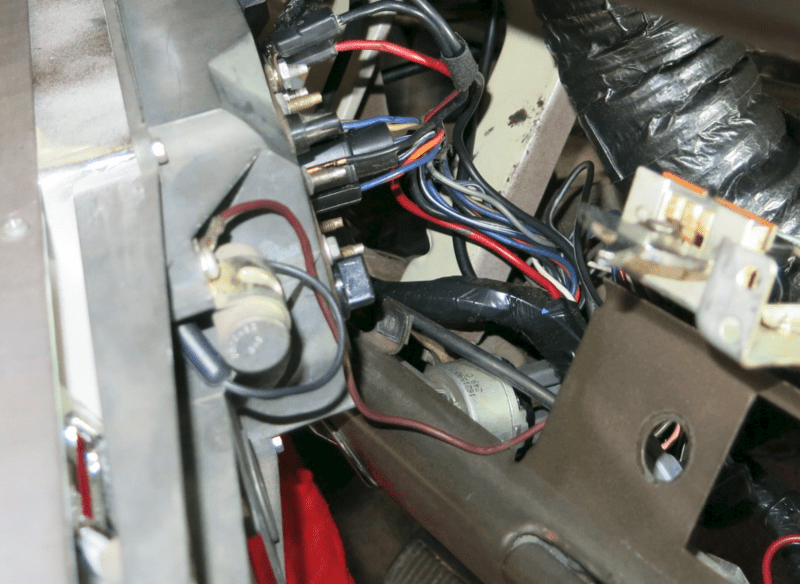

IVR on the Rally panel grounds as shown here
Mattax, I think the IVR circuitry is located in the fuel gauge in a rallye dash. The lead you are showing is a ground for the noise suppresser.
Correct.
Follow the link for the IVR ground contact on the back of the fuel gage.
I was short on time so linked instead of copied those photos.
Your dash must be different than both of my Darts, no black wires in passenger kick panel, just the one brown wire.
That's the rally dash ground and I don't know if the '70 used the same. The other end attaches to the strut support for the radio.
Yes. Behind the kickpanel was another ground wire which connects to the heater core.

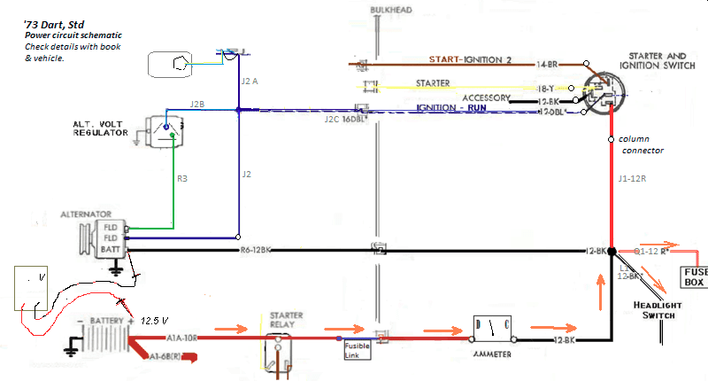

Thanks guys for all the imput. I'm not sure if anyone can help me on this. When the key is in the "ON" position dash lights are working except the signal light indicators come on but are very dim ( the flasher & the outside lights are flashing fine) (This is the same with the Hazzard switch) When I start the car the indicator lights are good. It is like there is low voltage in the "ON" position until the car is running. I guess this is not a real problem, I was hoping someone could try their car and see if this in normal . I don't want to pull the ignition switch. Thanks
Part of it is the power supply.
Answer this. What is the max voltage the battery can supply power at? What is the normal votlage range for the alternator to supply voltage at?
Up to the welded splice current from each follows a different path.
Test for resistance in each using voltage drop.
Begin with a charged battery (use a charger) In fact for the is test you in some cases you could leave the charger on it.
Turn on something that draws power. The more power going through resistance the larger the voltge drop. V=I x R
The ammeter will show how much current is getting drawn from battery.
Measure the power supply voltage. Then go measure voltage differences from the power source (Bat positive) to other accesible locations along the feed circuit.
Then remove the charger, start the car and let the battery charge back up. When the ammeter shows zero charging, do the same checks as above but from the alternator's output stud.
Unless you have or make very long meter leads you may not be able to measure voltage drop all the way into the passenger compartment.
Options are:
A. Cheat. When the battery is supplying power, use the alternator's output wire as a lead extension going to the main splice.
^^This is actually a great place to begin.^^ It quickly reveals if there is a voltage drop between the battery positive and the main splice.
If there is none, or very small, then that whole feed line is OK.
Then start the engine. Once the battery is charged, turn the lights on, and do the same but with the high voltage lead (red) on the alternator poutput stud.
B. Measure voltage to ground, and subtract from voltage at power supply. This assumes no resistance in ground circuit. You can also check that, at least for the battery. Measure the votlage differnece from some place on the chassis to the battery negative terminal (not the clamp, the terminal) with the lights on or whatever your test item is.
Diagrams illustrating the method here:
