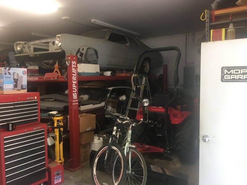

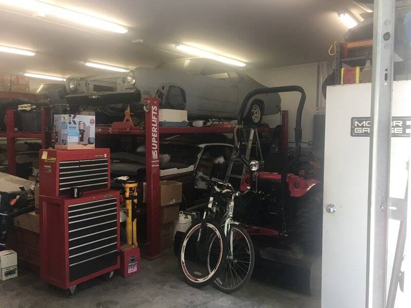

Finally drank enough coffee to go take pics….lol. I was wrong about my ceiling height, it is 10’ 10”. There is 5” between the Duster roof and the light bulbs. You have to leave room on a 4 post to go up and clear the locks, so you can let it down. I could stand up under the Duster to work, but it would be nicer if I had a 12’ ceiling and could raise it up a few more clicks. Hope this helps some. Excuse my mess….lol. The shop is 40 x 40, and has 8 vehicles in it, not counting the Suzuki TS-185. I swear, if a man built a shop 500 x 500, it would be too small in a few months! Hope this helps.

Thanks JD ,
So,,if I had a 12 foot ceiling I would for sure clear okay .
Those pics are very helpful .
Tommy
You're welcome Tommy. Unless you were working on a 4WD pickup or SUV on the lift, 12' will give you plenty of room. I had to duck and dodge when I had a 2WD 2004 Dakota on mine so I could work under it. I'm 6' tall and could work up under the Duster just fine as it sits now. The biggest problem I have run into is that I had to tip a bellhousing on the 545RFE transmission to get it out from under the lift while sitting on a transmission jack that is made to work under a lift. It only needed an inch or so to clear the bottom of the lift, so it wasn't that hard to do. When I got a lift, I had to learn new ways to work after laying on my back up under cars my whole life.
