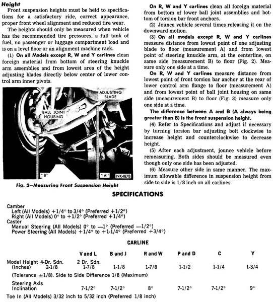

I'll also add for the OP that you probably shouldn't raise the car higher than the original factory height. The suspension geometry for running radial tires gets worse as you add ride height, even the factory height isn't ideal for radials or a more modern alignment. The factory manual provides that measurement, "V&L" describes the factory A-body ride height. Most cars get lower over time, so more than likely your car is lower than the factory spec for height already.
