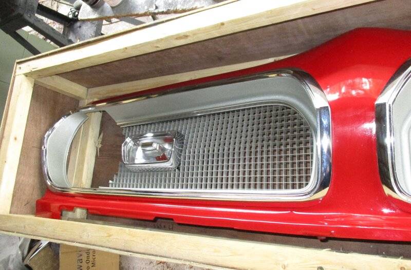

I have just Premiered my latest video on YouTube:
"How to Alter the PG Classics '69 Barracuda Grille".
It shows you how to make the poorly engineered grille into a usable grille for our unobtanium grille world.
https://youtu.be/K8F7tKMeE9U
Guys, DON'T PURCHASE THE REPRO 69 CUDA GRILLES FROM PG CLASSICS OR ANYBODY ELSE. :eek:
They will not refund you, but give you credit instead.
These aftermarket total crap parts will NOT interchange with any OEM 69 Cuda Grille parts.
There are MANY more problems he does not address in the video.
We had to quit redoing these Grilles because the repro crap is getting mixed into the OEM versions, creating total havoc.
In reality, the 69 Cuda grille parts that YOU order, may be even worse that what he shows in video.
Hold out for some originals. They ARE out there.
The cheap chrome work will start pitting within a year.
Most body shops will not even do these kinds of mods, let alone a Car guy.
WISE UP, GO WITH OEM!!!!!
