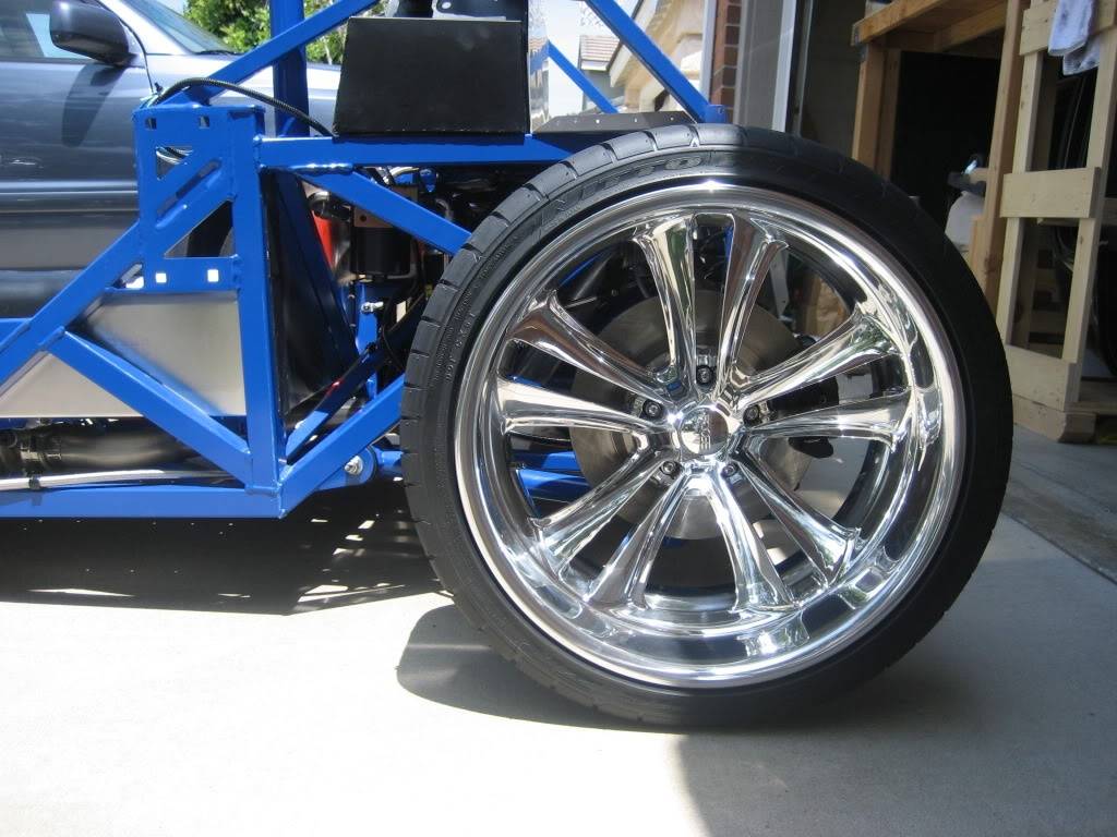

Changing my Small bolt pattern to Big bolt pattern. The reason is because they have more wheel options. Please let me know the cheapest way to do this. Can I get new axles? And should I get disc breaks from a 73-76 Dart? The wheels I want are 18" 5x4.5 and the wheels I have our 18" 5x4. Any info will help. Thanks,

Ok I'll bite. What are we looking at? The wheels you wish to put on your Mopar I presume. That blue frame musn't be whats left of your Mopar is it?
Am I seeing rear engine?

Im going to gess that the wheel pic is just to show the size of the rim that you are leaning twards? I did a front and rear small to large bolt conversion also. I got the upper control arms from Ebay witch you will need, I beleave the calipers and disks i got at NAPA any 76 or above parts number for the dart, or duster with dicks should work, as for the larger rear drum and the Axels for my 8 3/4 391 posi i got them from Doctor Diff, the axels came with the berring already pressed on, i bought a few pices here and there and once i had it all we did the conversion. if I had to poke at a price 550 600 range.
