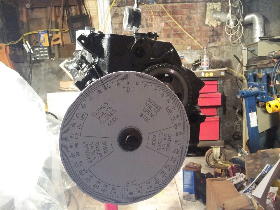

I made my degree wheel by glue a printed degree wheel on a cardboard. But it didn't work so good, I wanted to turn the engine around with the balancer bolt and the cardboard just compressed and twist when you turned it around. So I did a new degree wheel with a aluminum sheet, works better since you can look it in place with the balancer bolt. In the pictures is the setup for my 318. I guess you have to make something else to connect from the cam to the indicator on a slant, something longer. If you have a old lifter you can maybe weld something on the lifter to bridge the gap up to the deck and indicator. I took 2 (hydraulic) lifters and taped the pushrod side to each other. You don't want anything that can compress between the cam and indicator.

In this picture is the cardboard degree wheel. I had to turn the engine by the flexplate to not offset the cardboard degree wheel.
