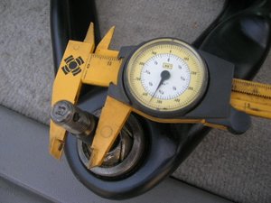

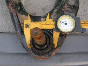

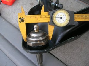

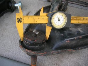

Here's a few pics for you.....If you need more measurements or can't read these, let me know. As far as I can tell, the only difference in the control arms is the size of the opening for the ball joints. There is however, a big difference in stud diameter and length of the ball joint stud which accounts for different spindles between early and late.
The above 3 pics are of a 72 and earlier UCA.
These 3 pics above are of a 73 and later UCA.

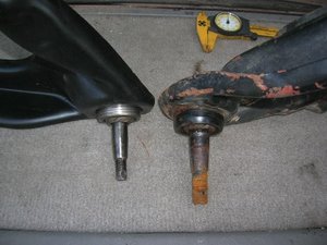

Here's the 2 of them side by side. 72 and earlier on the left and 73 and later on the right.

Bingo, you win the Kewpie doll. As it turns out, I found a pair of each like yours in the trunk of a parts car I bought. It never occurred to me to compare the ball joint tapered studs. I was focusing on how there wasn't much obvious difference in the top of the ball joints. As you pointed out, there isn't any noticeable difference in the shape of the UCA itself.
Thanks for the measurements. They jive with what I am finding on mine.
Another mystery solved.
