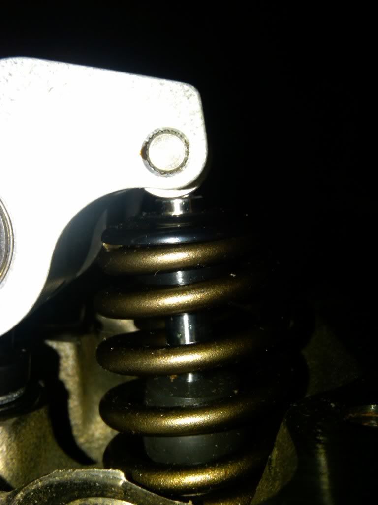

Brian, here's a picture of the roller resting on the valve tip (closed position)...just in case what I was saying didnt convey the idea. hehe
Too far toward the intake side, correct?
I'll get the sweep pattern later. I have a meeting this morning and I'll do some more tinkering soon as I have time.
Yep that's too far off IMO. Those valves I use are .096 taller than oem so I wouldn't think that would be enough to do that. The valves are sitting exactly in the same spot as the LA heads we do, and the Hughes LA rockers fit perfectly and the sweep is down in the .040 range.
If they were typical stud and guide plate rockers you just lengthen the pushrod to get what you want. But those you'll have to raise up some. I think using the cut guide plate method you talked about might be the best way to go. You want as much support under that pedestal as you can get.

Agreed. I just wanted to see what you thought. You're the guy who sees a lot of these situations all the time and has to solve them. I'll give that a try.
It's like I was saying earlier. it's not really a problem per se, just something requiring an adjustment and I wanted to make sure about the smart way to go about it.

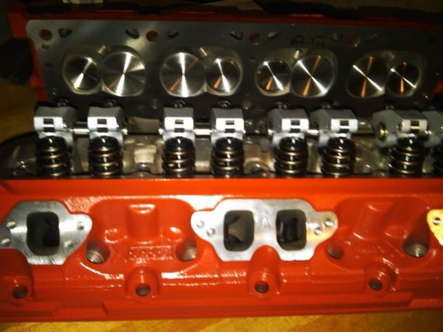

This looks a lot better shimmed up 2.5mm.
I'll have to still see what the width and location of the sweep pattern across the stem tip is. I just wanted to know what i'd need for now. Final geometry will be squared away when these are on the assembled short block with cam in it that I still need to get.
I'll get a coat of paint on these this weekend.
Should be a really nice setup...
That looks better.
At least the issue is on the side of your valve stem that is easier to correct.
Nice work getting it in shape

Yeah I think that looks ok. See, this is kind of a weird deal because typically with a magnum you're using a stud where the rocker can easily be raised/lowered, and juggled with longer/shorter pushrod to achieve the correct geometry.
But I'm using a head meant for a stud with a pedestal shaft rocker because using an LA head is the easy way.:toothy10:
I really wanted to use these shaft rockers because they're unique and I like them. This is what its all about though. Figuring out how to make things work the way you want them to. If it's too easy, there's no gratification in the end. Besides, if this is the biggest "issue" I have, I'll take it. It aint nothing.

I run Hughes rockers on my 416 with Eddie heads. I had to shim the shafts up .120 to get the roller tip closer to the center of the stem in the closed valve position. I had the same issue before I did that as you did with the roller being way back on the valve towards the intake side. I called Dave Hughes and and emailed him some pics of the sweep pattern and he right away said I wasn't getting full lift because of the wrong valve geometry. He said that it is common on LA motors to have to raise up the rocker shafts to correct this problem. I used his aluminum rocker shim kit to do the job and so far it's worked out okay. He said that aluminum shims can be formed easier to the shaft when torqued down and will seal the oil hole better than the steel ones do so that's why they use the aluminum ones over the steel shims. Plus his kit shows you how to trim the shims to get the best fit if you need to use multiple shims instead of just one to get the height you need.

I was mearly commenting on your valve geometry based on the pictures you provided and saying that I had the same issue even though I'm running LA heads and that yes, I had to raise that shaft to correct it by shimming under it! I was under the impression that you were wondering about the position of your roller tip on the valve and if it would work or not and if you needed to do some shimming to! At least I thought that's what you were asking in the first threads with the pictures. LA or Magnum matters not. What matters is the correct valve geometry. The rocker roller tip is supposed to be just slightly back of the center of the valve stem in the closed valve postion. It will roll out from there and then back during complete valve lift and seat.
