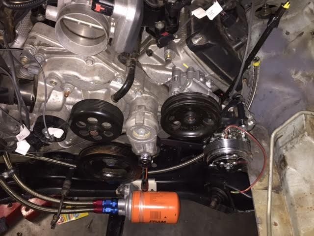

Installed some remote oil lines as I didn’t have room to fit the 45 degree Jeep/Durango adapter bracket due to the location of my engine mount.
Engine oil and transmission oil for TR6060
