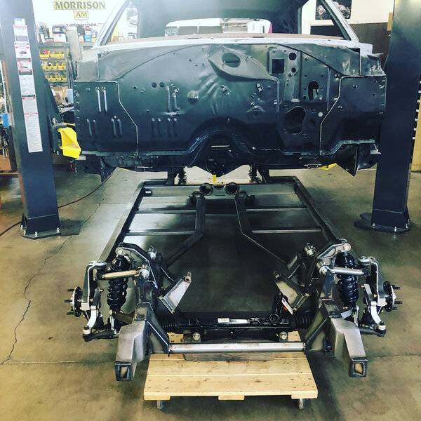

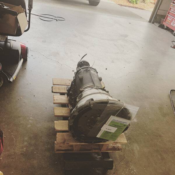

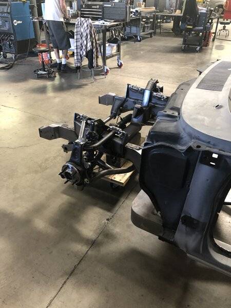

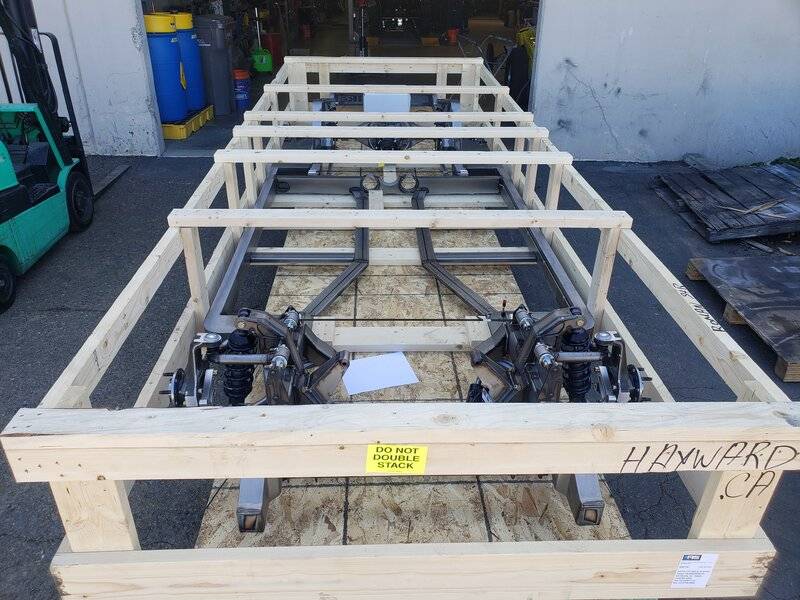

I know this isn't an A body, but I though some of you might like to follow me on my 68 Charger build. I'm using a full perimeter frame from the Roadster Shop with a new drive line, a Gen3 392 hemi with a 8HP70 8 speed. This should be a fun build, no pressure to get it done, and it will most likely be the last one.
is that an "off the rack" frame they have or did you specify the pick up points? guessing the later since the motor mounts are already to go.

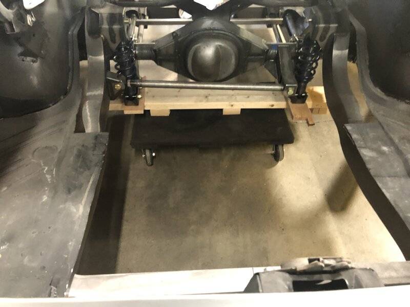

pretty cool build. I hope you keep us posted with regular updates. Looks like coil overs hanging at the rear...4 bar, 3 bar?....what ya got going back there. Are their plans for a roll bar?
***** (close as i can get to 5 stars)
Hi Denny, it’s a 4 bar triangulated ford 9 inch. Don’t think at my age I’m going to need a roll cage. Coffin maybe but not a cage!.

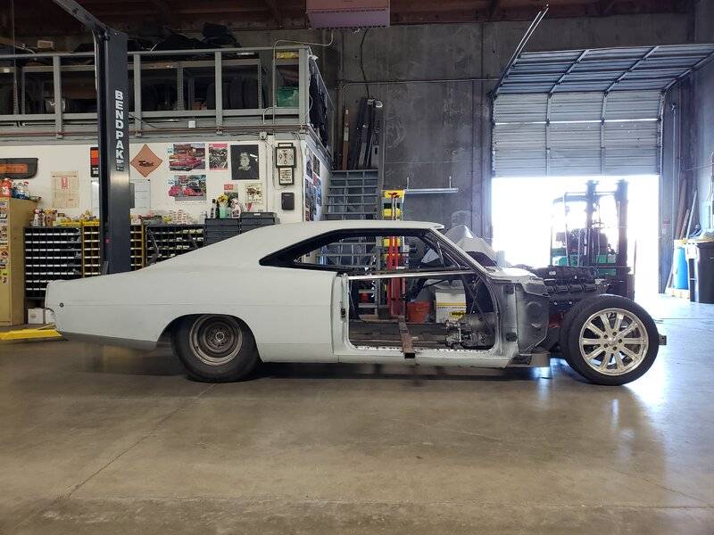

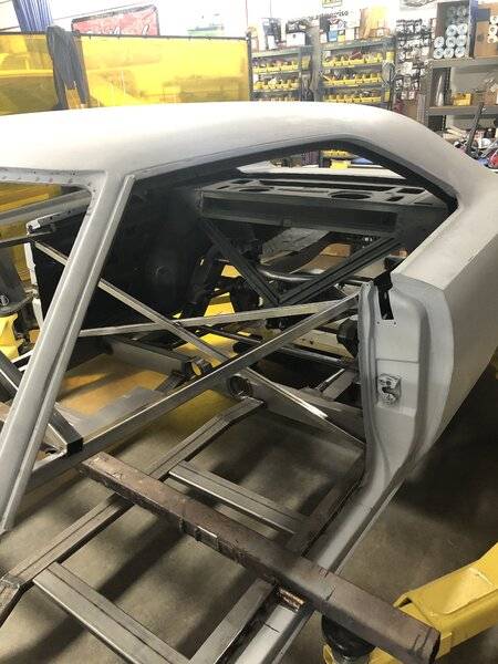

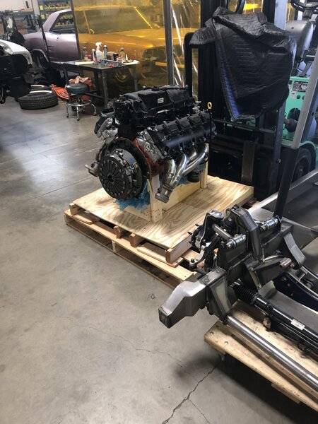

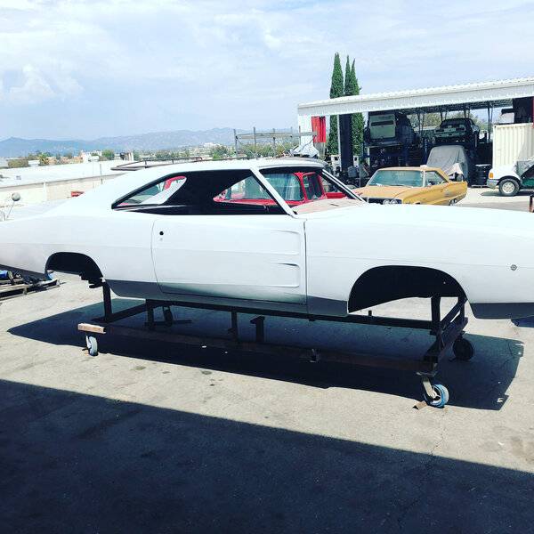

Well, the body is on the chassis. It seems I've got a size 6 engine and a size 5 body. Next plan is to move the engine back and down to gain hood clearance.
At the moment the pan is above the bottom of the chassis. To get the engine under the hood, the engine needs to drop about 2 inches.

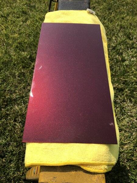

Compani Color will be painting the car, I picked the color from their palette wheel. So (I’m smiling) the color is: C2M MR368.42
Thank you. If only the shop was mine. The car is at South City Rod and Custom. Fabulous fabricators!!!
Those are Glasurit numbers. Good stuff. That's what I like to use. Hats off to South City Rods and Customs.

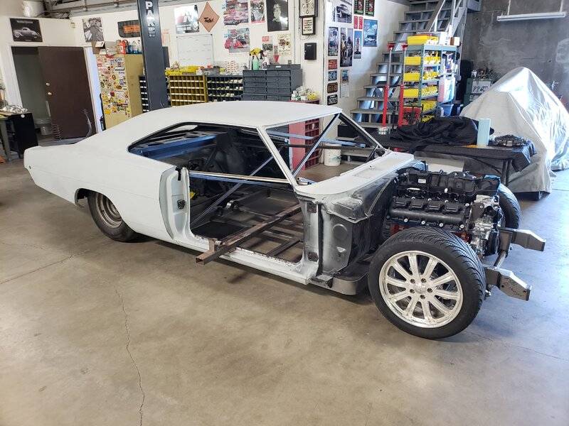

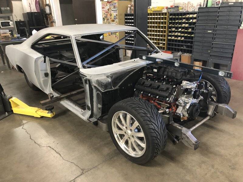

Here’s a picture of the fenders mocked up. You can see how much higher the engine sits, it’s going have to go down.
