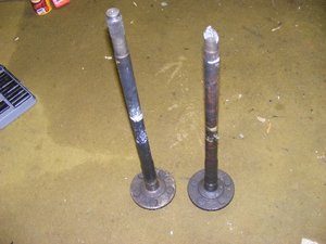

You should know better to try and run a warmed over 360 with a 7 1/4.I would even skip past the 8 1/4 and go straight after a 8 3/4.Problem solved.Here,s an axel from a 8 1/4 s.g with 4.10,s behind a warmed over 340.Lesson learned.:read2:
