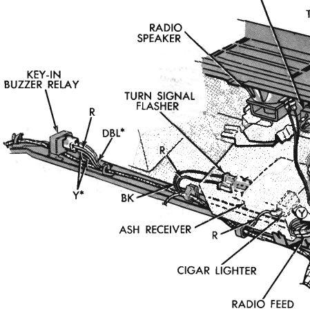

:mad: 70 Dart turn signal flasher, gives me one click then silence. my manual says its by the ash tray left side. well hanging upside down on my bench seat for an hour, still havent located it ! Any tips? will removing ashtray and ashtray bracket help? Im old and large lol Thanks

I think that one is for 4way flasher turn signal should be on left side near fuse box
Reading manual again Challenger is mounted to ash receiver, Dart is supposed to be on right side of steering column Im goin down under again, Oh lord give me strength lol lol

If its in the same location as the 60's, its very hard to see the first time. Its on the side of the ash tray housing.
According the 1970 Dodge Challenger and Dart shop manual, its there.

On my 73 Dart the signals flasher is just to the right side of the ashtray.
Yup I got it backwards darn dislexia
Manual is 1970 Dodge Challenger & Dodge Dart service manual, Yellow cover downloaded @MyMopar.com
Ok I never used this "My Mopar" but between this thread and your horn relay thread it sounds like there is a lot of inaccurate info in there. I'm old school and have several original Mopar Factory Part and Factory Service manuals. You know, printed on real paper by the people who designed and built these cars. The T/S flasher has been on the right side of the ash tray on these old cars forever. All my 62-74 cars are that way. The EM flasher is either on the right or left side of the column depending on the body. Same for all A,B and E bodies. Truck are different.

ok thanks moparmarks ill check that location next. Thank you for all your help :thumbsup:
