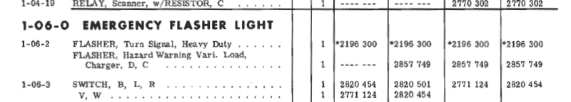

Parts book lists 2196300 as flasher unit
This website is selling a "NOS" 2196300 flasher
Buy 1960-75 Chrysler Tung-Sol 2 Terminal Warning Flasher Made In U.S.A. NOS 2196300 motorcycle in Beaverton, Ontario, Canada, for US $20.00
The NOS flasher is a tubular flasher, So I am still not sure if rectangular or tubular is OEM correct?

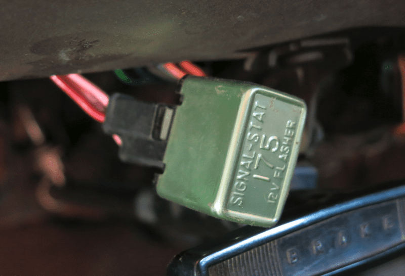

The 175 is the emergency flasher.
The round 223 on the ashtray housing is the turn signal.
There were different versions of the turn signal flasher that I've seen; long, short, and short plastic.
The later ones, short plastic, may have slightly different heating rate to go with the 1157 bulbs and if any sidemarkers flashed with the turn signal. I can't recall my '75 doing that but that doesnt mean much.

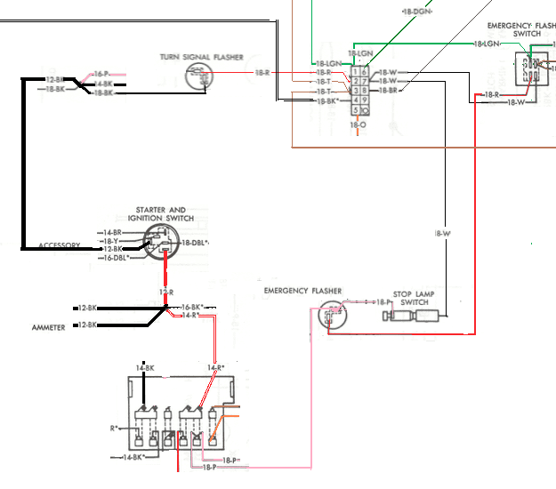

Turn signal is power from the accessory splice. Black wire. No power with key off.
Hazzard is powered from the main splice. Pink wire. Fused. Always hot.
