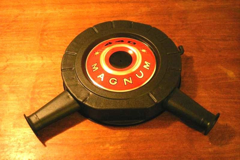

I need to refinish my 69 340 unsilenced air breather. About 10 years ago when I last painted it I went thru hell trying to get a nice even wrinkle finish. I tried a couple different brands but I don't recall what they were now. Any advice?

I wound up using the SP-201 VHT black wrinkle paint. I sprayed it and baked it in the oven for 1 1/2 hours. Came out pretty good. Had a few blemishes on it which I sanded down and re applied the VHT. I then used a heat gun on it. Turned out perfect. Thanks for the help.
