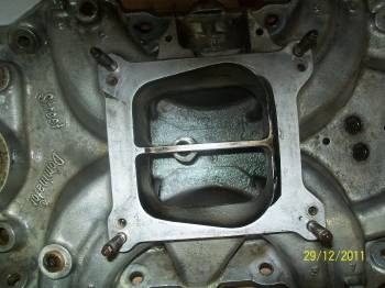

THAT INTAKE MANIFOLD is a spread bore, correct? What did you do to insure sealing around the carb base? What spacer/ adapter/ gaskets did you use?

67Dart273, I think you may have something there. I used a spread bore gasket between the intake and a 1/2" phenolic spread bore spacer and a spread bore gasket between the spacer and the carb. I do have power brakes. I have not tried to remove the PCV and power brake lines and see if it makes a difference. I will try that this weekend and I may even get a spread bore/square bore adapter if needed.

If you can find one of these --notice the price-- it should solve the problem. Intall at the carb end of things
http://www.jegs.com/i/Edelbrock/350/2732/10002/-1
After I read your post, I looked at the exact same thing and I noticed the price and said,Dang, I should just get one of those and try. I will be checking the PCV and brake booster lines this weekend and more than likely ordering one of these plates.
