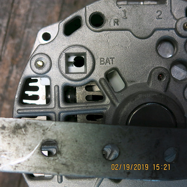

As far as Delco providing genuine OEM GM quality, sadly, no. The retail parts sold by AC Delco and Delco-Remy no longer are OEM quality replacements.
This was bought in 2019 came in a box with the correct GM part number
I didn't notice the cockeyed output terminal until on the last leg of a 600 mile trip, the ammeter swung over to discharge. A quick check showed the output wire was loose. But the nut was tight. ****. Fortunately there was just enough daylight to make the remaining 85 miles to my house without using headlights.
Junk!
and notice the label. Its was done for GM by some other company. Boo.
The original culprit was the insulator.
Junk!
This is not the type of out-of- spec that that would occur in modern OEM parts. This sort of BS was addressed in the 1980s with the adoption of statistical quality control throughout the supply chain.
I got lucky, and it didn't short the battery and melt the fusible link.
- rant over -

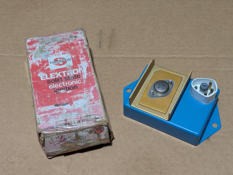

Ok another one
Ive been working on cars for a long time and I've bought a lot of "Standard"/ "blue streak" parts over the years for these cars and trucks.
(All brands not just the ones I've owned)
So up pops a 4 pin LX 101 ignition box on eBay. Bit this one says "standard elextron"... THAT, I've never heard of. There's no "T" on the end of the part number so I don't believe it's the cheapest version.
I bid on that one and won it, and since I'm seeing ads pop up for other standard elextron ignition boxes. Most are wanting a lot more for than what I paid .. though this one was listed as being for a Ford??? No way. Ford never used an ignition box that looked like the Mopar one. Probably why I got it cheap.
Who knows what about the "elextron" designation?
I will say the back isn't melted out like some do but it sure is sticky like fly paper. The enclosed sheet was stuck to it and tore away when I peeled it off.

The Elextron products were an alternately named line from Standard Motor Products. Standard introduced the line in 1977 using the name to highlight the, then relatively new, electronic ignition components. The name faded away in the 1990s.
Standard has, or had, other sub-brand names for different product lines that they acquired or marketed differently, such as Hygrade for fuel system parts and Ektron for wire and cable.
Blue Streak was introduced in 1934 as a premium line of ignition and electrical components. Similarly, but alternately, Standard introduced an economy/separate line of components in 1989 which formally became Tru-Tech in 1995. Tru-Tech evolved into the T-Series of economy parts, which have the "T" suffix on the part number. The "T" number is typically otherwise the same as under the Standard line, for example, LX101 and LX101T.
Initially, Tru-Tech was a less costly, but decent line. Over time, it and its T-Series successor became lesser quality with overseas production. Unfortunately, much of Standard's other products have suffered this same fate.
Elextron parts were good quality though, and largely, or all, made in the USA. The following image is an Elextron LX101 that I have had for a while. It's a spare, but was tested fine when I first got it. It was made in 1983.
