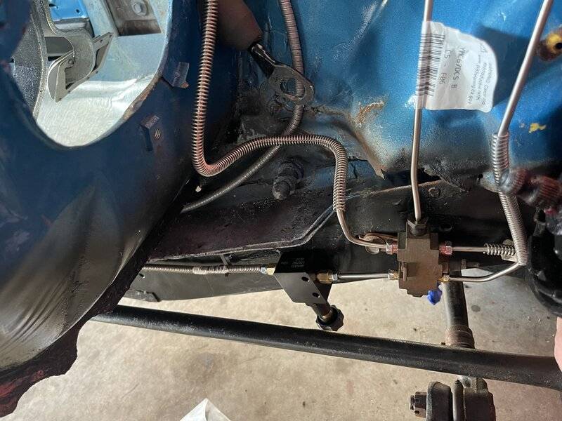

Relocated from rear floating axle setup to front. Made a mini line to connect the rear proportioning valve and bring it all together finally!
There are no rubber lines on the car.
That's really impressive... how does the rear axle move up and down, or the front wheels steer without brake hoses???
CONGRATULATIONS!!! Looks like you are ready to roll... I mean stop... you know what I mean!
Braided-steel/synthetic cores.
Looks good. Since yours was a drum-drum car, the factory block is just a "distribution block" with a pressure imbalance warning switch (to dash lamp, in parallel w/ hand brake switch). For anyone with a factory disk-drum car, you wouldn't want to keep that different "combination block" since it has an internal proportioning valve which lowers pressure to the rear drums. The added adjustable proportioning valve is mandatory if adding front disks and keeping rear drums, to reduce drum pressure to avoid locking up the rears first. In your case, it wouldn't be needed if front and rear disk brakes are equally matched, so might need it set to just slightly reduce rear pressure. Ideally, test the brakes in a wet parking lot, with a ground observer. Adjust until the fronts skid just before the rears.

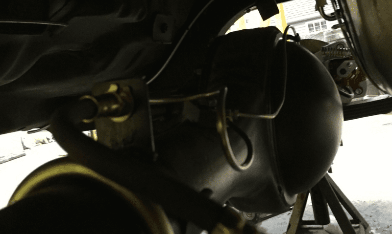

A few photos for what it's worth in helping you solve your problems. I have the same 4 wheel disc brake kit on my Dart, but did not purchase brake lines from them. I made my own line from the proportioning valve to the rear of the car (I chose not to use their proportioning valve, bought a factory style disc brake p-valve) and have factory style rubber lines on the rear. I either made or bought the tabs welded on the rear axle housing to secure the lines. Engine compartment lines were from in-line tube. I did ditch the master cylinder for an aluminum one from Doctor Diff as I could not get it to stop leaking around the cap. E- brake lines are a pain as they sent equal length lines that were not useable as the line runs down the drivers side, so I had to source the longer line and had to split the mounting tab and on the body and relocate it to get equal line tension. A lot of work and trial and error was needed to get it right, but the cars brakes are just right not over powered and not under powered.
nice thanks for all that good to know its almost there like yours i dont have a welder so i have these securing straps for the axle hose securing brackets
