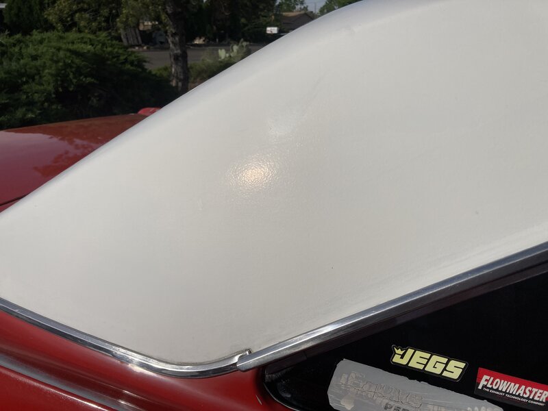

These seems where the roof and quarter panels meet were done with short strand fiberglass and painted with a 4 inch foam roller using tractor paint from Tractor Supply.
I did this 6 years ago and it’s holding up great aside from some surface haze of the paint.
It’s never been buffed or polished, just washed.
I quit using Bondo plasic filler for bodywork years ago, as the fiberglass holds up way better.
Just in case anyone was considering fiberglass and tractor paint but was hesitant to try it.
