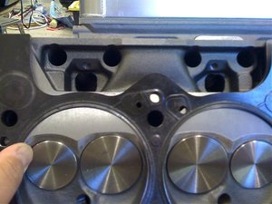

The water jackets on the intake side between 1&3 and 5&7 on the intake side will not seal off. The cometic gasket embossing is not large enough to seal this area........It is the same on the opposite side of the motor same place.
It WOULD FOR SURE leak like a stuck pig if I would not have caught it.......
The Felpro's have a blue seal that goes right around the water jackets.

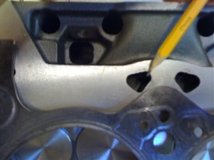

I really gotta see a pic of this missalignment.
Can you post one please, thanks.
Yes I will try to do it. I always have a hard time posting pictures for some reason.
I will take a few pictures before work and post them today if I can figure it out.
Someone have instructions on how to do it?? The mis alignment is VERY minor but it would for sure be a mess....
Help loading the pictures would be a great help!

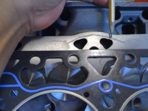

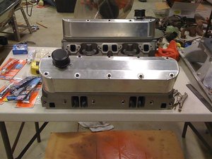

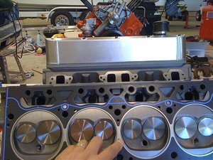

Ok, here are some pictures I hope they are attached. On the Cometic, there is just a MINOR gap where the embossing on the gasket would seal around the water port......but it would leak like crazy if assembled this way.

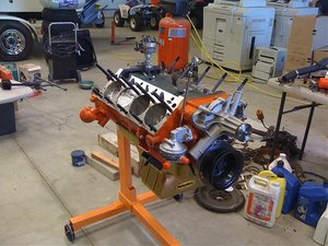

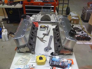

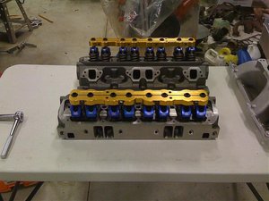

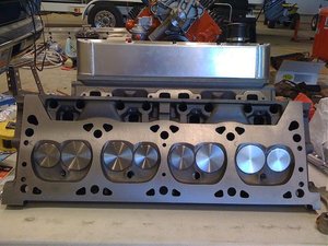

More pictures to follow of what I am working on.

Ahhhhhhhhh, those wonderful little things in life that cause so much problems.
Thanks for the pic.'s.
Louis,
From what I see the Fel Pro looks to have the same problem but on the oppsite water port. If thats the Fel Pro with the blue sealing ring.
