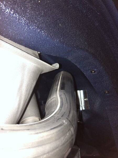

Photos - just what I am looking for. Here is what I have. Nothing exotic

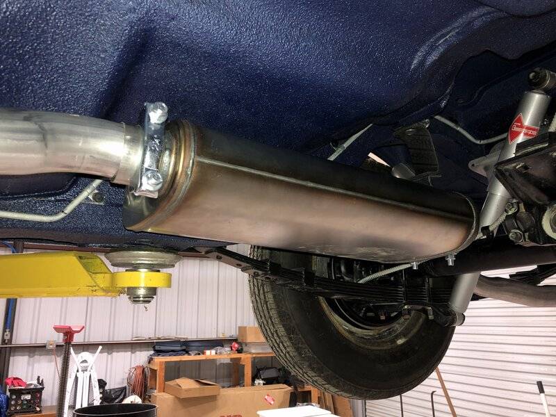

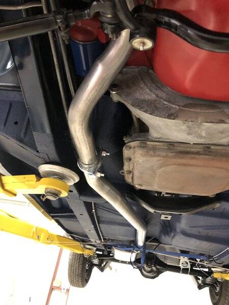

Starting at engine, looking back and at the muffler

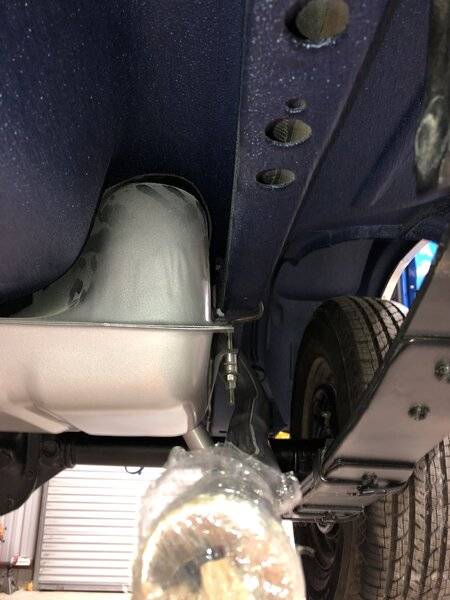

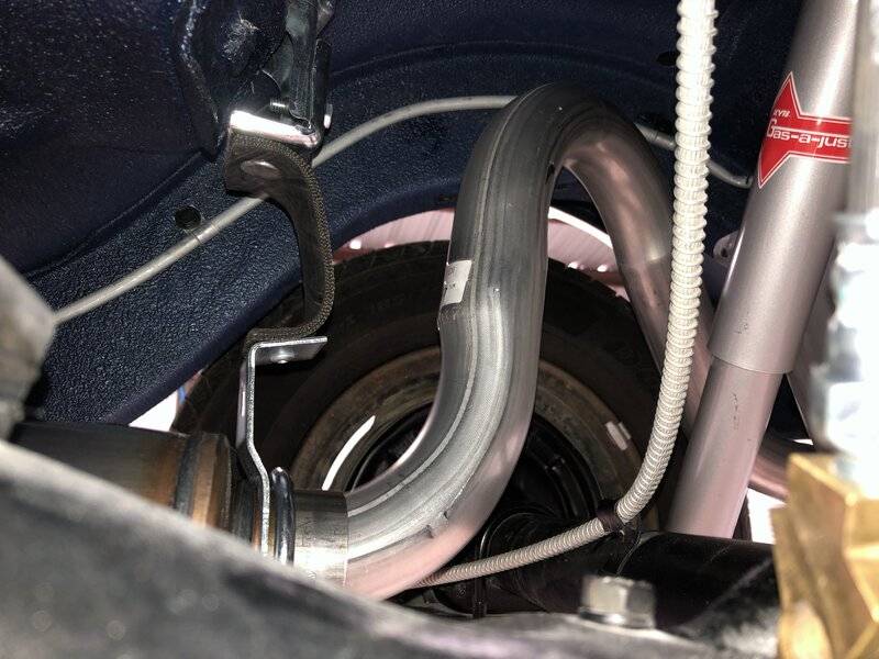

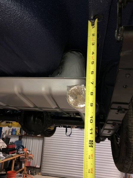

Here is the exhaust pipe, crossing diff, snaking past the shock and gas tank.

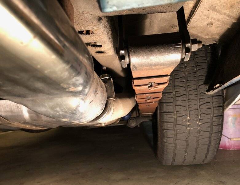

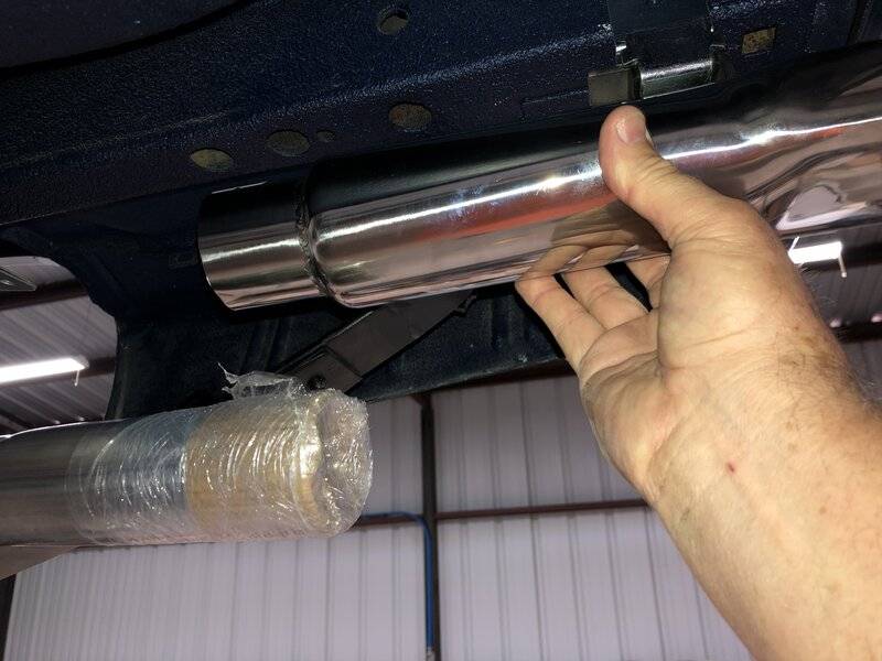

And the modified gas strap bolt, tail pipe out the back, and where the tip fits
As much as I hate the idea, I can drop the gas tank and move it about 3/4” to the left side, allowing more modification to the strap bolt, or drill a hole and move it inside the frame rail.
Everything I brainstorm still has the tailpipe slightly off center and several inches too low.
Rob it looks like the muffler is way too low but I can't see why. Any images of the hanger assembly bracket on the car?
Does Tom at Accurate make them for this car with the side biased gas tank like the 67 has?
The muffler bracket is as high as it goes. Top of muffler is about 3/4” from the floorboard.

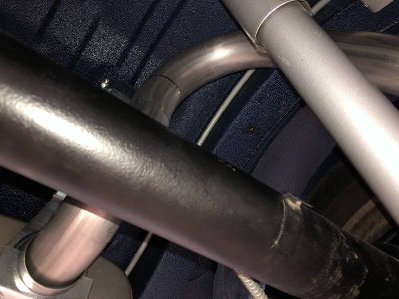

Hanger bracket, from the back and side. It is as high as it goes.
You can also see the muffler to floorboard.
Just looking at the pix, it looks to me like your hanger is too long. I would disconnect the hanger, then manually lift the muffler with a hydraulic jack or however and see if by doing so you can get the tailpipe where it needs to go. If so, get another, shorter hanger.
3/4" is close enough but something is weird about the tailpipe's height unless it is just the camera view. It seems my 69 tailpipe is very close to the floor when all is in position. The tailpipe normally sits next to and slightly lower than the Frame rail but it can't with that tank in that position, can it?

The long pipe in front of the muffler is about 1/2” from the floor. The muffler sits level. Seems like the exhaust pipe (or something I am doing wrong) is the problem.
I knew at the start, and Accurate reminded me, the gas strap hanger would have to me moved. I’m OK with that.
If the gas tank hanger was the only problem, I would mark the area and get a new bend or flatten the area with a hammer. Before I use brute force, I want to convince myself I have tried everything else.

Another one. I can get better ones tomorrow. I can raise it but leave the rear end in place relative to the suspension.
To me the tail pipe looks like it was made wrong and too long. The pipe appears to be too far in the muffler, as the pipe on my 69 340 Dart looks nothing like that. my exhaust pipe by the way is one piece,
