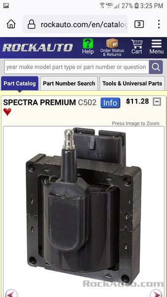

Use with an E-coil
Straight 12 volt to the coil, no ballast resistor required.
Runs Cool
