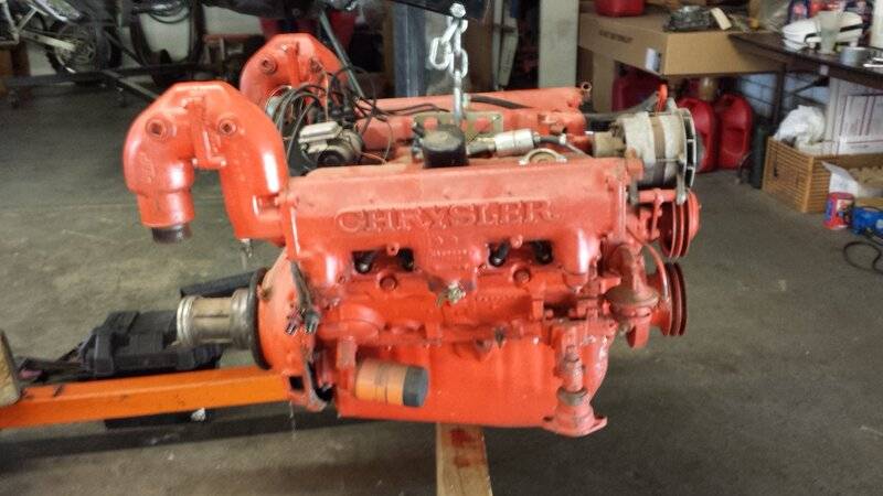

Just starting a plan and trying to use what I have which is a fresh 340 boat motor, the set of RPM heads and the two manifolds. Don't even know which car it is going in.

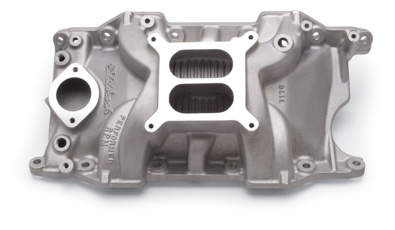

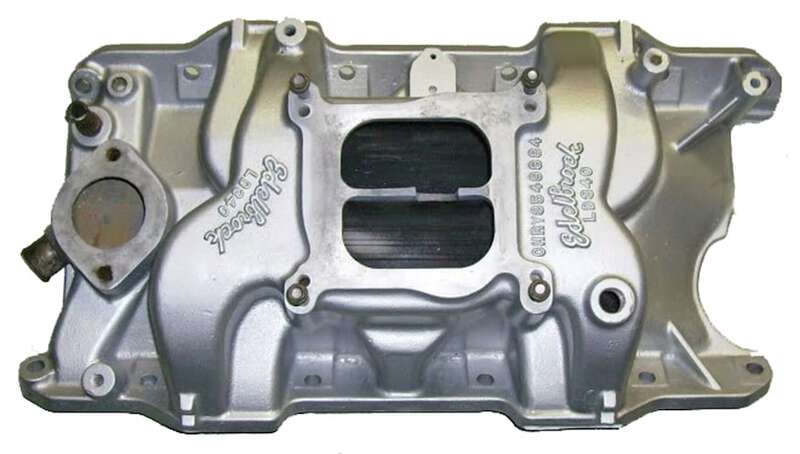

That Performer RPM looks suspiciously like a LD manifold.
From the article I linked above.
05 mopar small block intake edebrock ld340
Edelbrock LD-340 Shallow Port Match
Scatter279.2 - 314.1 cfm
Spread35.0 cfm
Average299.7 cfm
Test note:This was the best 4BBL intake for small-block Mopars for many years. This particular manifold (borrowed for testing) had a port match that was only -inch deep. The flow is impressive for an ancient dual-plane, but the flow bench does not always tell the entire story.​

06 mopar small block intake edelbrock performer rpm 7176
Edelbrock RPM
Scatter248.6 - 264.9 cfm
Spread16.3 cfm
Average255.9 cfm
Test note:This intake has an excellent and well-deserved reputation and has taken the place of the LD-340. This is one of those cases where the flow bench does not tell the whole story. This manifold did not flow as much as the LD-340, but it will produce more power. Why? Look at the manifold intake runners. Notice how the port shape and runner arrangement has changed from the older LD-340 to the RPM. The runner lengths are shorter and the cross-sectional areas are more consistent from the plenum to the head. Lots of flow work and testing went into the newer intake design which paid off in horsepower.​

The runners in the Performer are thinner width wise. I wonder if they are taller though compared to the LD340. Improved velocity? Just spit ballin' here.

Fresh boat motor? Better make sure it's not a reverse rotation engine, or it won't matter which manifold you pick. But you will have the fastest car in town- in reverse! :lol:
I used to run an air gap and then switched to a Victor 340. It made a difference. Much more throttle response. I do have 3.91's out back so that might be a factor too.
That can be a very particular thing, build dependent.
Yup I checked that first. It's standard rotation. It's a 1974 Super Bee III 340. Small cam and small heads.
