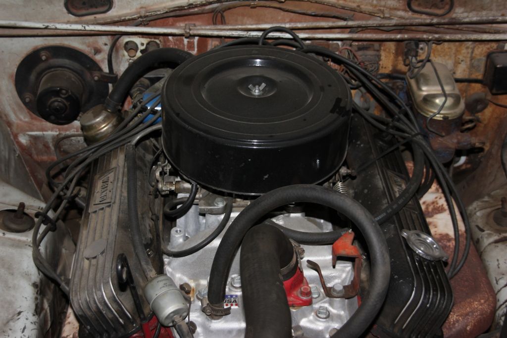

Will this carb & manifold set-up fit under a 62 Valiant bonnet ????
There will be an adapter plate, and a 3" K&N aircleaner on top.
