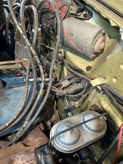

There is a wire (not factory) coming off the under-hood harness that was plugged into one of the wires that comes out of the bulkhead connector that would normally go to the transmission wire. I disconnected this non-factory wire so I could wire my new junkyard harness like in the service manual. Now it will not start even though it is set up like it is supposed to be. I can totally disconnect the new harness and plug in the non-factory wire to the bulkhead wire, and it will start and run but I have no interlock safety or backup lights.
The photo shows the non-factory wire shoved into the one of the two wires that would go to the transmission harness before I put the new harness in. It starts in this
bad wire.jpg configuration but I want the safety interlock and reverse lights.
Does anybody know what someone did to defeat the interlock and how I can put it back to factory?
The wiring for the neutral start switch is incredibly simple, and you should be able to trace it easily. The CENTER terminal of the switch on the transmission grounds when in neutral or park. That wire, from the center of that connector, goes up the firewall and plugs into one of the two "push on" connectors on the start relay. The remaining push on connector is the "start" power from the ignition switch when twisted to the start position.
Those two "push on" or flag terminals on the star relay are the magnetic coil terminals. So the power, in start, comes from the key, to and through the relay coil, then down to ground through the neutral switch.

I already told you how it works. The center pin of the switch is grounded. That is one wire. It goes from the start relay, one of the flag terminals, down the firewall to the NSS. So start by grounding the relay terminal and see if it cranks using the key. BE CAREFUL as you have bypassed the switch function
Then check the wire, either check continuity, or reconnect it and ground the center pin.
Also hook it up as it should be and hold the key into the start position while wiggling the shift lever from park to neutral, which will check for poor switch operation, linkage mis alignment, etc etc.
What Del said above. I'd recommend removing the starter wire and just checking the yellow and brown at the starter relay. Show us a pic of the relay. You need a DC volt meter to do any intelligent diagnosis.
how about some photos of your starter relay. There were some relays that had one of the starter pins grounded so only the yellow wire from the ignition was needed (no NSS)
Thanks for everybody's help. I got it working right! I kept tracing the wires from the relay. The ground wire was put on the ignition lead at the relay and a jumper wire went from the ignition lead on the relay to the bulkhead connector where the transmission harness goes. The previous owner did this. I undid the crap and got the transmission harness in. I have backup lights and it only starts in park and neutral now.
