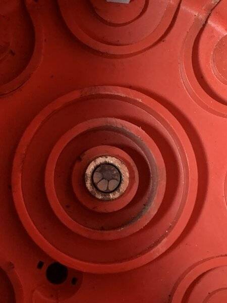

So I’ve taken a look at my distributor and this is what the center of the cap looks like, does it look like it is damaged ?
I see nothing there, particularly alarming

So this is what has been installed on the car, MSD Blaster coil, MSD 6AL ignition with an MSD 8534 distributor. The ECU box looks like it be original (or very close to it)
The cap looks like an MSD. The center should have a little black nip that the center part of blade of the rotor rests against. Get a new cap and that will fix it. But before installing, look in the lower part of the distributor for the back nip, most likely chewed up…

I did not notice the cap button. "Something" caused that. It may have been wear, or it may have been something else. Check your plugs and wires for opens. Was it arcing anywhere such as a plug boot before this happened? Missing occasionally? Also check the rotor carefully for "punch through into the shaft area.
Also if you go to the MSD website there is a test procedure there. Examine the interior of the distributor for shaft wear, debri around the pickup/ trigger area, and heavy rust.
I hope the cap & rotor fixes the problem, but I have my doubts...
