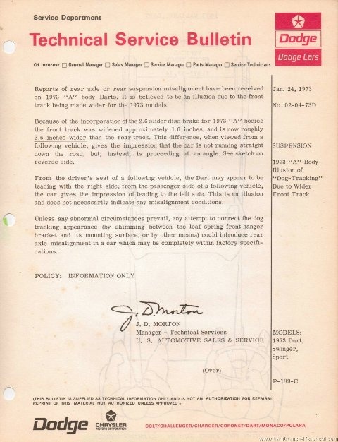

Normal. There was actually a TSB on it back in the day because people thought the cars were side-tracking. The large wheel houses on the Duster make it look even worse than it is though.
And, it is actually worse on the 73+ 7.25" rear cars. I was under the impression that the 7.25's were the about same width as the A-body 8 3/4's, but they're actually narrower. And not by a little, the 7.25" rear axle that was in my Duster was a little over 1" narrower than the spec for an A body 8 3/4.

Here is the TSB.
attachment.php
Not only the A body but Dodge full size vans. I never understood the theory with the vans. The A's yes because of using the Larger spindles for the disc brakes 4.5 bolt pattern.
