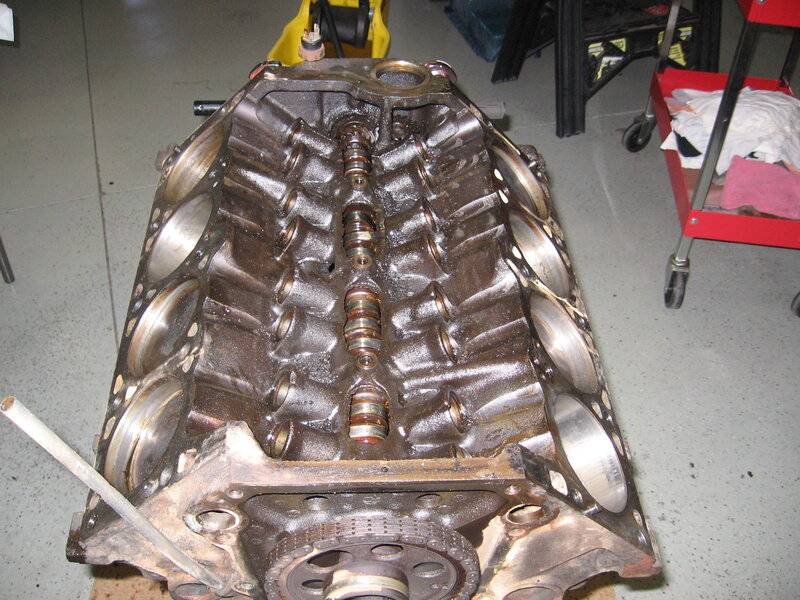

I will tell you that I took apart a 1984 roller cam 318 and it had a rope seal.
Ma Mopar did many things so who knows ?

It's probably about 8 yrs since I did a 100% rebuild on my 64 225. It most definitely had a rope seal. I think my rebuild gasket kit included a rope seal but I thought I'd update it with a "modern" lip seal. Also I was yrying to maximize power and a rope creates more drag.
I do remember the seal area on the crank had a directional knurling designed to direct oil toward tge seal. I'm pretty sure I smoothed that out some with some fine sandpaper shoe shine style. I don't think anyone has talked about that knurling.
