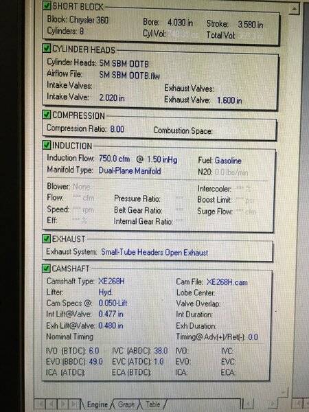

Looking at the input screens for Toolman and Stixx sims...... they both have different cam info than what the motor used, and the specs I listed.
The cam used was a Comp XE268, part number 20-223-3.
Specs are:
268/[email protected]
224/[email protected]
.477/.480 lift
110lsa
Installed at 106

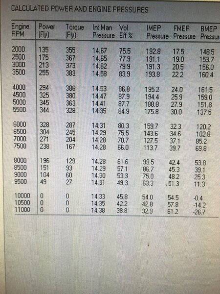

It’s still puzzling how Toolmans program is adding in the neighborhood of 100ft/lbs over the other DD programs.
How about posting a pic of the flow file?
Maybe there’s something off there.
