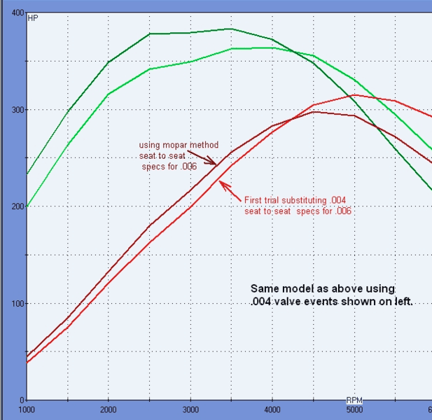

Late to the Desktop dyno party, but a couple observation using the Dynomation version.
@stixx, @PRH and @toolmanmike.

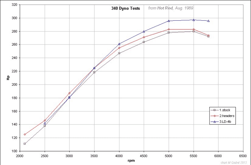

If you recall we compared a 340 build to some of the magazine 340 dyno tests.
The only way to get the program to show a curve that looked like and peaked at the same rpm as the real dynos runs was by estimating the actual .006 using the .004.
Compared with for example Hot Rod's Test at Edelbrock in '69 or some of the more recent ones.
Edelbrock LD4B
A couple things I've noticed with Dynomation and I assume desktop dyno.
The fill empty method makes big jumps in the curve when the hi-po intakes are selected, bigger carb, etc.
Putting in actual head flow numbers helps get a little more realistic results sometimes.
I started to fiddle around with the rod ratio (use a chevy with same cam for example) to see if the program took into consideration dwell time - didn't seem to.
To use the wave-flow model, one really needs to have a bunch of measurements including the port volumes. Good for learning the effects but otherwise GiGo.

But the program needs a seat to seat based on .006 (ie like Comp cams uses)
So what we did is use the .004 at the valve (1.5 rockers) that you had info on, maybe from an Elgin catalog?
See this post 340 cam specs? and posts 11 and some following.
Using the mopar numbers, or any .008 duration for seat to seat shifted the power curve down and into the lower rpms. Also showed a fast drop off in power after peak.
Using the .004 duration, the program predicted a power curve more in line with what it should be.
So using .004 is the best we can do with DD and Dynomation go until we get some .006 measurements from some real Chrysler cams.
This Dynomation version can't properly handle asymetric lobes. At least not with regular basic inputs. We'ld have to feed in a cam doctor file to see how it would reinterpret that. Since there is a new version that came out 2 years ago, could ask Larry Atherton or maybe on Speedtalk if the new version's cam manager handles the asymetric lobes.
The fact we were able to bring the curve shape and HP peak into the ballpark is a major improvement. At least now we can run simulations and have some degree of confidence of the baseline simulation (factory 340).
To PRH's point, look how much that change in seat to seat affected the predicted torque.
The model used for the above is Fill and Empty simulation.

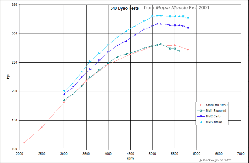

Compared with HR, Mopar Muscle's baseline is very similar. The power gains from the add-ons (carb swap and intake swap) show more gains..read into that what you will. Neither article mentioned what rate of acceleration was used.
The problem with building 318 simulation is similar. We need a good baseline sim to really get a sense of what various changes might do.
