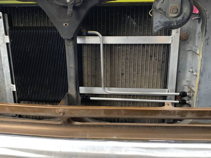

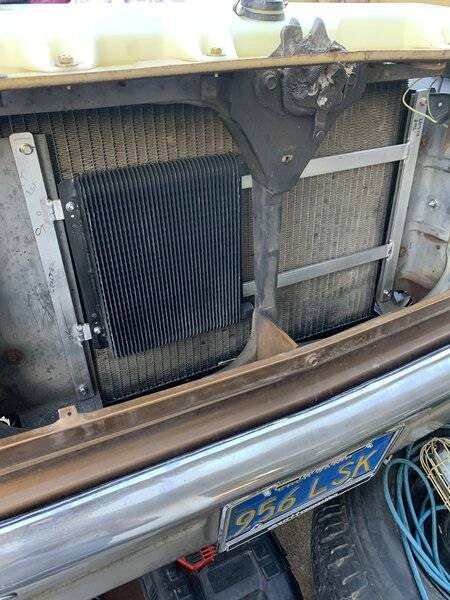

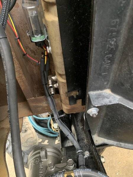

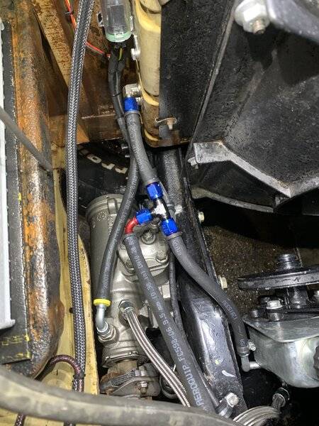

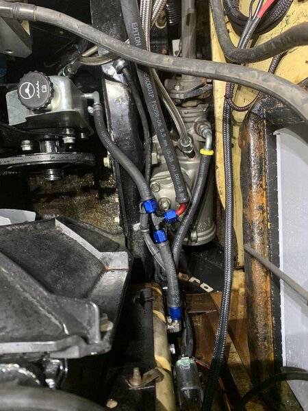

Okay. Power steering cooler bracket made and mounted. Just gotta plumb it all in.
Well it works. The temperature of the fluid before adding the cooler was 160-180 degrees. You could not touch any part of the metal lines. Now the lines are just warm to the touch, I was recording about 100 degrees after adding the cooler.
