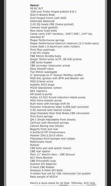

Some good reading there. Duner/MadDuner peaks his head in and is one of the Dakota guys who has made 700 reliably for years(136mph @ 4,000lbs). I have his complete build list(he posted elsewhere) and it’s not even exotic; stock head bolts, eq heads. 700 to the wheels by the way. Digging through different forums there are many examples of turbo builds in the 6-700hp range. Dizuster pushed his stock cast crank into the 850(140mph @ 3700lbs) range with lots of boost from a box stock s475. I don’t believe I’ve seen a single turbo block failure so if you know of any please post up info for the community. That would be valuable to me personally.

These two run 8's no problem with hundreds of passes on a stock block, no hard block filler, no girdle, STOCK. People need to stop with the non sense. Detonation kills blocks. I also ran a 351 Windsor block for over 100 passes with a stock cast crank and hyper pistons on a 350 shot, no controller. It ran low 9's like that. Never broke the block. Both the Duster and the Dart are full steel cars. Dart weighs in at 3400 pounds and the Duster is 3300.
