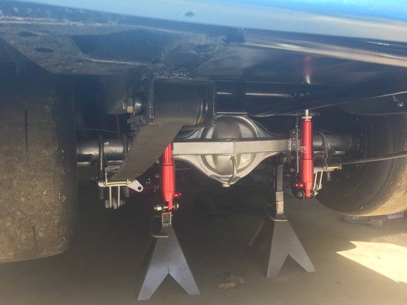

I was told not to use both together. But I already had them bolted in. Converter flashes to 4200. 1.451 sixty foot times. It I do have problems when the track isn’t prepped good. I have mine with zero peel ones on the drivers side and 1 turn preload on the passenger side. Kim
