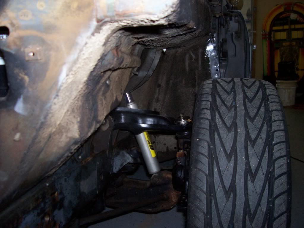

Update on the dart we have it in my shop wanted to do some rebuilding on the front end so we took the fenders off. Sure made it easier to work on things!
Pulled the upper control arms off and had new ball joints installed also put new bushing in, cleaned them up and painted em.
Installed new shocks while we where at it. That's about as far as we got before Larry blew two disc's in his back. He had to go through about two months of Bull S**T before they decided to operate and fix it. Day after the operation the pain was gone, He has been doing everything the doc tells him to so he can make a full recovery. At 26 years old I think that is a very smart thing for him to do.

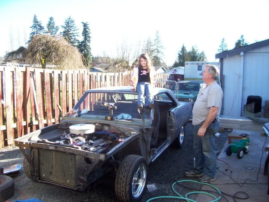

We where busy on the dart ntill the weather turned on us. Here's a pic of my Grand Daugther sitting on whats left of the poor thing!

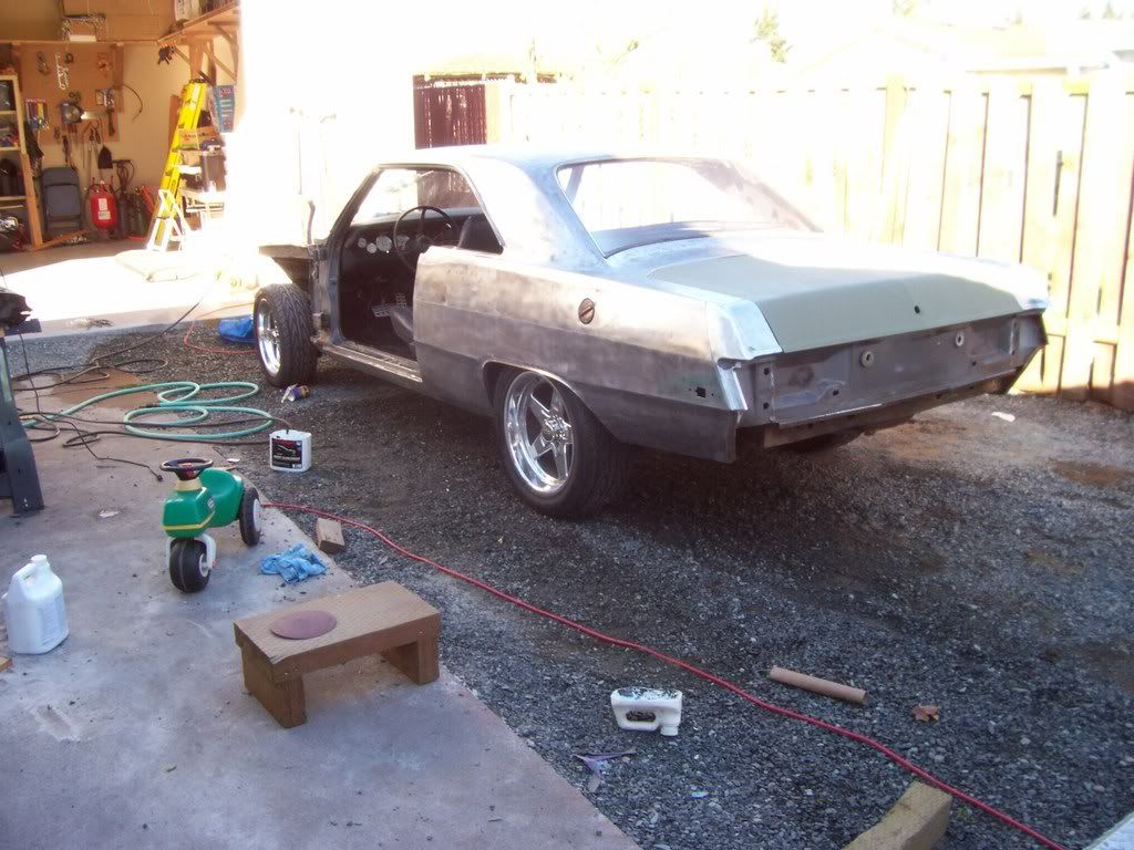

All the old paint is off.
We put new pins in the door hinges. Sprayed the whole thing in etching primer, and started on the body work. Been on hold for a couple of weeks now due to snow, rain and just crappy cold weather. Hope spring gets here soon so we can get busy again. :-D
