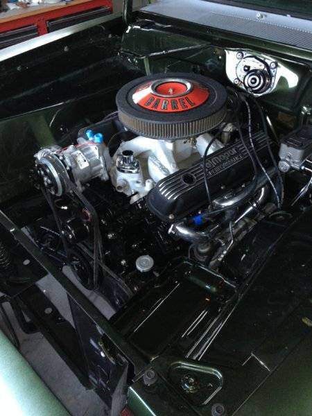

The MP valve covers are a little too wide which is why they often leak. The rails in the valve covers are offset from the valve cover rails in the head. So the gasket gets rolled over and they leak. I fought that for years then finally decided to just solve the problem by making my own valve covers with the correct dimensions. Now I don't have any leaks.

VERY nice job on the valve covers. When someone says they made their own, you often see Frankensteined, hack welded jobs. Those are very nice. Tell me about the distributor. I have never seen one like that.

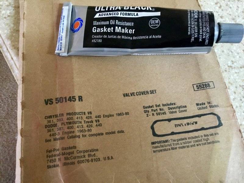

I HAVETHE MOPAR VALVE COVERS HAD THE SAME PROBLEM I GOT A SET OF VS50145R THAT FIX MY LEAKS THANK MIKE
Hay Mike, is that number for big block gaskets? & what brand (MP cast VC's/gasket combo)...or for a set of different valve covers altogether?
YES IT IS BIG BLOCK THERE ARE FEL-PRO THE VALVE COVER ARE THE BLACK MOPAR PERFORMANCE CAST ALUMINUM
