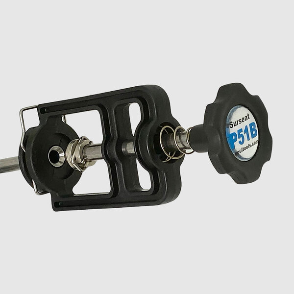

Having been through the pain of making and attempting to adequately seal stainless steel fuel lines I believe that there is really only one correct fix and that’s not by using washers! I purchased a KOUL TOOLS Surseat P-51B Flare Lapping Tool and would recommend its use above and beyond using washers as a Band-Aid fix - especially on brake lines!
https://www.amazon.com.au/dp/B09YFGV1DK?tag=fabo03-20
