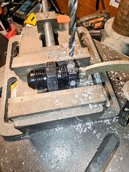

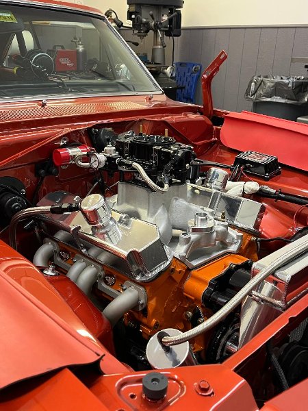

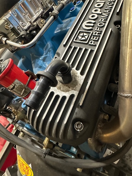

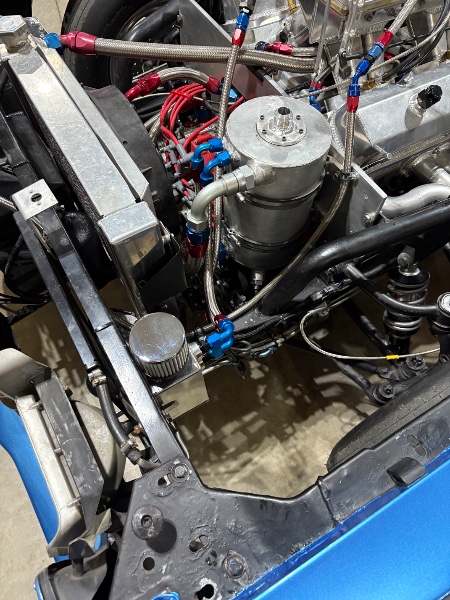

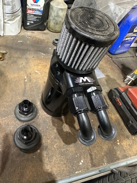

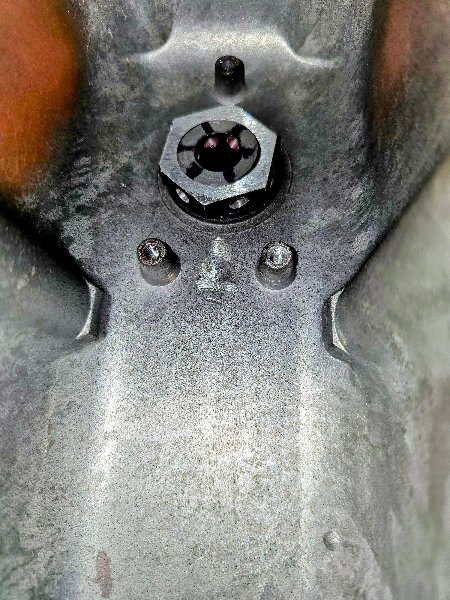

I used a bolt-on -12AN bulkhead fitting that I modified to fit in the valve cover under the sheetmetal baffle that comes on the Mopar Performance valve covers (baffle is not pictured in last photo). I cut it to clear the rocker arms and the baffle, drilled a bunch of holes through it and then ran it to 2 -12 AN single fitting Motion Racework's catch cans.

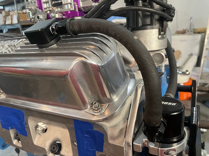

My evac from the valve covers to the header collector.

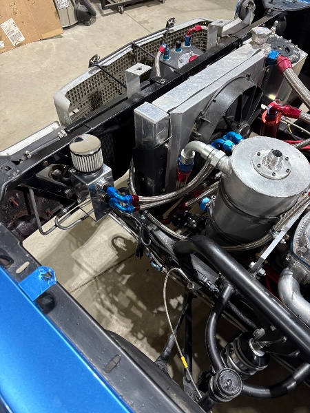

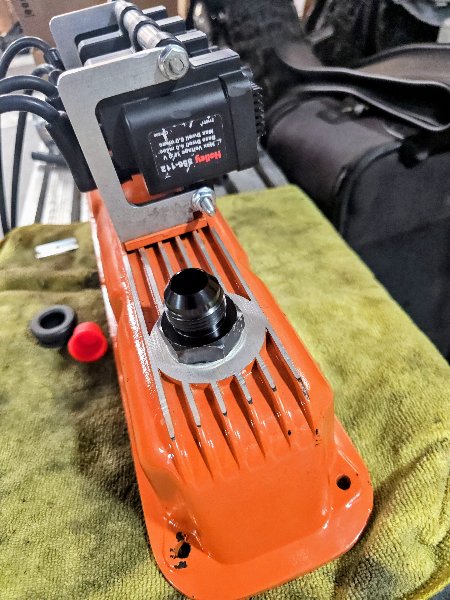

Here's mine. I connected to both VC, I had bungs welded to the VC and took a 1/4" think plate and bolted to the head and made the holes for the pump.
